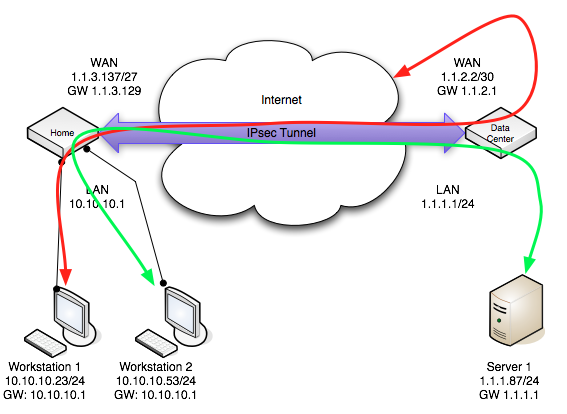

@Sindy, I tried your suggestion to route All the LAN1 traffic out of WAN2 (staying with traffic matching method). It works ! But when looking into the link, https://wiki.mikrotik.com/wiki/Routing_through_remote_network_over_IPsec
it seems the application is one specific device (10.10.10.23) in LAN1 (10.10.10.0/24) route its traffic out of WAN2 , the rest IP still route through WAN1. If this is the case, is there anyway to achieve it (without the help of other PtP tunnel) ?

It wasn’t clear from your previous post whether the fact that the default route via remote site (WAN2) applies only for a single IP in your LAN subnet is something you want or something which is described on the wiki you refer to and you want something else.
So looking at the drawing, I assume that you want the tunnel to work only between site 1 LAN and site 2 LAN for most devices, but that single device in site 1 LAN should use it also to access internet via site 2’s WAN.
If so, you need an individual policy for that single device, example:
src-address=10.20.30.40 dst-address=0.0.0.0/0 …
src-address=10.20.30.0/24 dst-address=10.11.12.0/24 …
The policies are matched the same way like firewall rules or routing rules, top to bottom until first match. In this case, the order is not relevant, because it doesn’t matter whether packets from 10.20.30.40 to 10.11.23.0/24 will be sent using one or the other SA.
