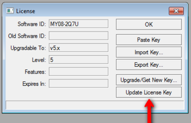

Just comparing my V3.30 to the one included on the Wiki “All_about_licenses”
the tab on V3.30 it has “Buy New Key” while on the Wiki it’s called “Upgrade/Get New Key..”
