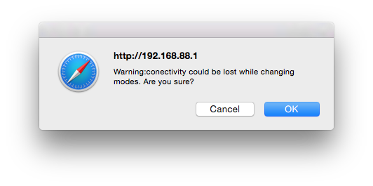

To clarify, it does ask you “if you are sure” before changing anything:
