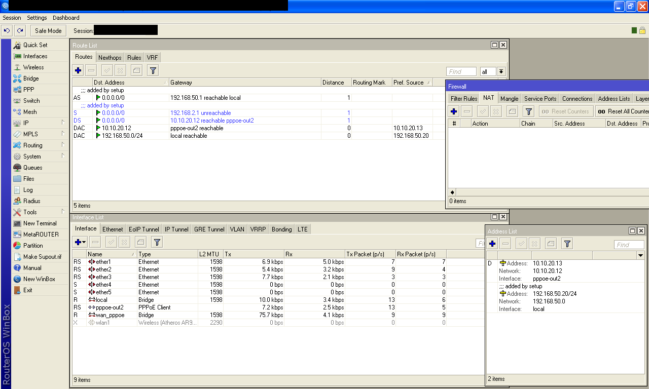

I played back the backup to the Mikrotik with the original configuration of the guy in my village and made a screenshot of it. For the help, the next beer will be payed by me! :slight_smile:

Maybe it’s just me, but I’m a little lost in your description. Instead of screenshot, select New Terminal on left, run “/export hide-sensitive”, post the output and you may have better luck with that.
