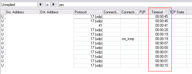

currently anything between 30 minutes and 23.40 hrs
curiously my filter is inverted.
I have to filter>
Unreplied is no… not yes as would be expected!
