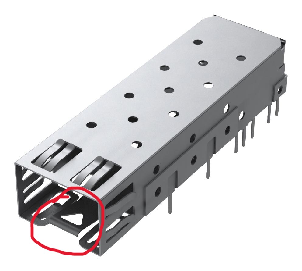

Dumb question; how do I remove a DAC cable from the SFP+ ports on the CRS326? Just tugging on the pull tab on the transceiver doesn’t seem to work like on my other equipment. The cables and CRS326 are relatively new and well cared for, so I don’t think the transceiver or port are damaged.
There is a locking mechanism on sfp cage. Sometimes you need to gently push sfp forward and pull unlock tab accordingly or wiggle locking mechanism with needle.
