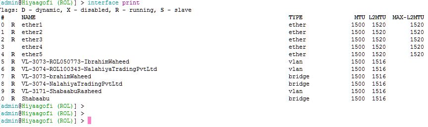

below is interface print
[admin@Hiyaagofi ] >
[admin@Hiyaagofi ] > interface print
Flags: D - dynamic, X - disabled, R - running, S - slave
NAME TYPE
0 R ether1 ether
1 R ether2 ether
2 R ether3 ether
3 ether4 ether
4 R ether5 ether
5 R VL-3073-ROL050773-IbrahimWaheed vlan
6 R VL-3074-ROL100343-NalahiyaTradingPvtLtd vlan
7 R VL-3073-brahimWaheed bridge
8 R VL-3074-NalahiyaTradingPvtLtd bridge
9 R VL-3171-ShabaabuRasheed vlan
10 R Shabaabu bridge

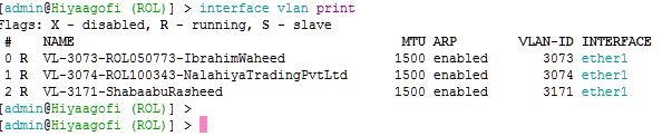

here is Vlan Print
[admin@Hiyaagofi (ROL)] >
[admin@Hiyaagofi (ROL)] > interface vlan print
Flags: X - disabled, R - running, S - slave
NAME MTU ARP VLAN-ID INTERFACE
0 R VL-3073-ROL050773-IbrahimWaheed 1500 enabled 3073 ether1
1 R VL-3074-ROL100343-NalahiyaTradingPvtLtd 1500 enabled 3074 ether1
2 R VL-3171-ShabaabuRasheed 1500 enabled 3171 ether1

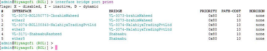

and here is interface bridge port print
[admin@Hiyaagofi ] > interface bridge port print
Flags: X - disabled, I - inactive, D - dynamic
INTERFACE BRIDGE PRIORITY PATH-COST HORIZON
0 VL-3073-ROL050773-IbrahimWaheed VL-3073-brahimWaheed 0x80 10 none
1 ether2 VL-3073-brahimWaheed 0x80 10 none
2 VL-3074-ROL100343-NalahiyaTradingPvtLtd VL-3074-NalahiyaTradingPvtLtd 0x80 10 none
3 ether3 VL-3074-NalahiyaTradingPvtLtd 0x80 10 none
4 VL-3171-ShabaabuRasheed Shabaabu 0x80 10 none
5 ether5 Shabaabu 0x80 10 none

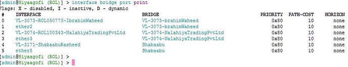

the thing is i want to rename interface name of "VL-3171-ShabaabuRasheed" and its bridge name "Shabaabu" to "VL-3171-ROL101745-Aliya-Haneef" and bridge name to "AliyaHaneef"
would appreciate your help
Thank You
Two ways:
Log in through Winbox and open the interface. You can change the name pretty easily there.
2nd Way:
show interfaces to see the line number of the interface you wish to change, then…
/interface set “LINENUMBER” name=“WHATEVER”
