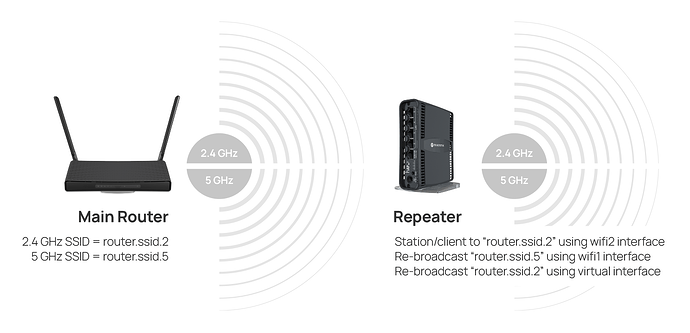

You are absolutely right, it works just fine. After studying the image below (part of the WiFi repeater article), I noticed my mistake. On the main router, I had set configuration.mode to station-bridge for the backhaul. It should be set to ap instead.
To spell it out for people who are a little slow like me:
  • On the main router, set both /interface/wifis to configuration.mode ap.
  • On the repeater, set one of the /interface/wifi to station-bridge.
