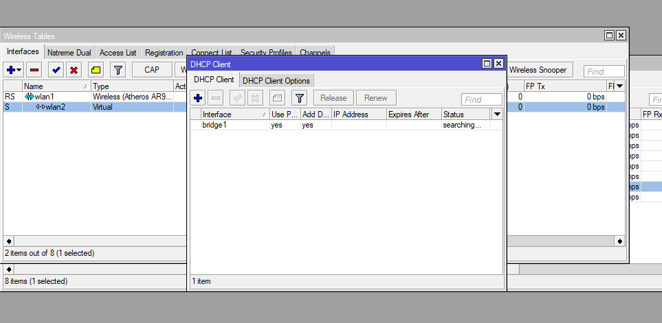

This is the problem.
Dhcp is searching. When I create Dhcp client with brigge
Is it connected to a dhcp server? Is the ap also mikrotik?

No ap is ASUS y router es RB3011 mikrotik and repetear is mikrotik 951 2hnd. I use in interface wlan station pseudobridge
Although the pseudobridge might work, note that bridging WiFi modes are guaranteed to work only with mikrotik ap devices. It is mikrotik proprietary solution because WiFi standards do not provide such functionality. Test with mikrotik ap or use routing instead of bridging.
Yes, I think I will create a new wifi network with 951G. Repeat I do not see it possible.
