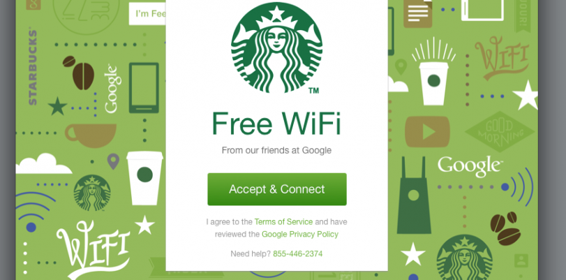

Hi – I’m interested in the same question… I’m using a Mikrotik Groove to connect to remote wifi access points, and everything works well until I get to a place where they’re using a “captive portal” that requires some form of interaction from a user (could be as simple as clicking a button, or as complex as providing a username and password in a field before clicking a button).
I’m attaching a picture of the simple case below – Here’s the simple screen I have to click on in order to access the wifi at Starbucks…
Is there any package or strategy anyone has used to get a device like the Groove to be able to connect to such a wifi network?
