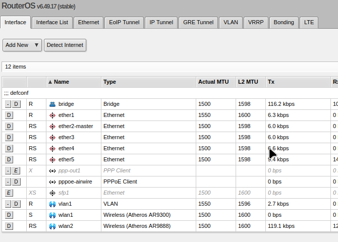

A storm took out my WAN connection (cable physically broke down outside my home). I bought a small travel router with a USB port and my phone is tethered to it and if I connect wirelessly to I can surf the internet (like now).
Now I want this router to drop in replace my WAN connection (temporarily until my ISP is back) but I have no clue how to do this. My WAN cable was connected to ether1 interface and it was configured with PPPOE
The new travel router issues IPs in the 192.168.8 range, my mikrotik RouterOS 6 issues in 192.168.0 range.
I connected a cable between LAN travel router and ether1 Mikrotik. The Mikrotik has wireless and wired connections I want to keep exactly the same.
I have no idea what to configure, attached screenshot with how I have it connected now.
Presumably I have to disable the VLAN and PPPOE entries in the interface list but not sure what to replace it with.

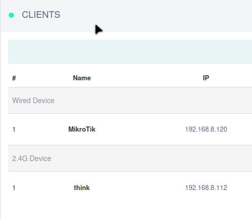

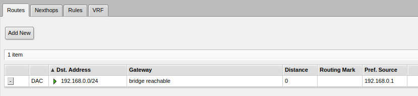

The travel router does hand out 192.168.8.120 and I see something in Routes but no idea what to do.
Any help greatly appreciated!

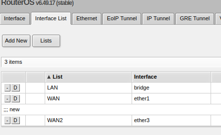

I have no idea what I am doing, I created a new WAN2 in Interface Lists
ether3 is connected to the LAN port of the travel router which has 8.120 as IP address.
But how do I assign ether3 to WAN2 and route all nonlocal traffic to it?
You made a new interface list, called it WAN2 and added to it ether3.
This only adds an entry to a new list (that you don’t want and don’t need). You only want the (default) LAN and WAN lists as they are referenced to in other parts of the configuration (firewall) and without changes this may prevent connection through any interface that Is not in those two default lists.

Now check your ip addresses and ip routes.
Ether3 should have a Dynamic address in the subnet of the travel router and there should be a Dynamic route with 0.0.0.0 with gateway 192.168.8.120 besides the “old” route with the ether1 or pppoe interface or address as gateway.
Very likely this route is already not Active whilst the new one going to the travel router Is Active.
