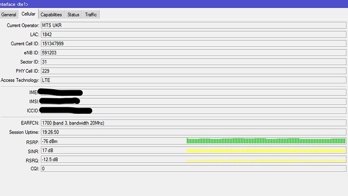

Hi. My LtAP mini LTE kit modem is broken.
In our country, the LTE 1700 range is used.
Is it possible to replace the modem on it?

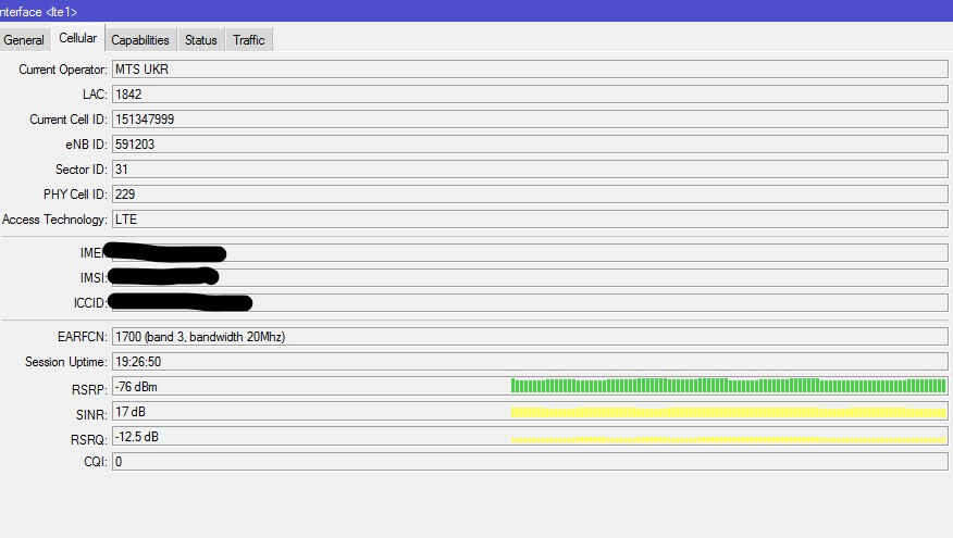

Oh, I was wrong.
BAND 3 is still used, although the frequency indicated is 1700
Number, shown with EARFCN, is not frequency expressed in MHz, it's channel number ... which corresponds to 1855MHz. There are many EARFCN calculators available on the net, this one is only one random example.
Thanks! I didn't know about that.
Then, both PCI modems may be suitable.
