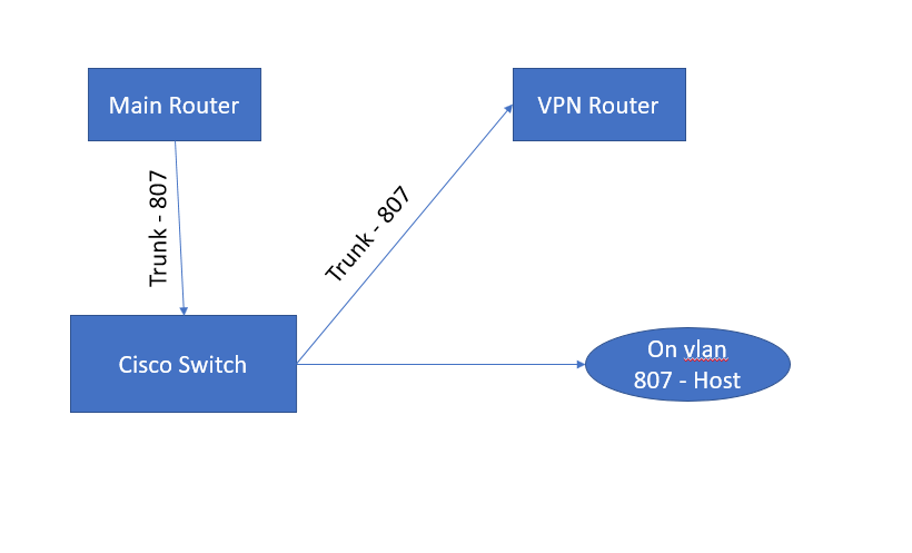

I have ccr router(172.21.16.1) configured as gateway for user and another mikrotik (172.21.16.2) configured as vpn server.
My scenario is ccr + vpn router + end host (172.21.16.15) connected to same switch on same vlan which is 807.
i have added an ip in vpn router from same subnet range which is in host device.
now my issue is whenever i try to arp/ping i get replies from ccr instead of the host. if i try arping i get mac flaps between the host and ccr.
usually i should be able to establish l2 connectivity between vpn router and host without ccr interference. but why am i getting replies from ccr is my question.

Yea, hard to follow from your description. A drawing with how everything is connected would help.
Also, export your configurations and post.
