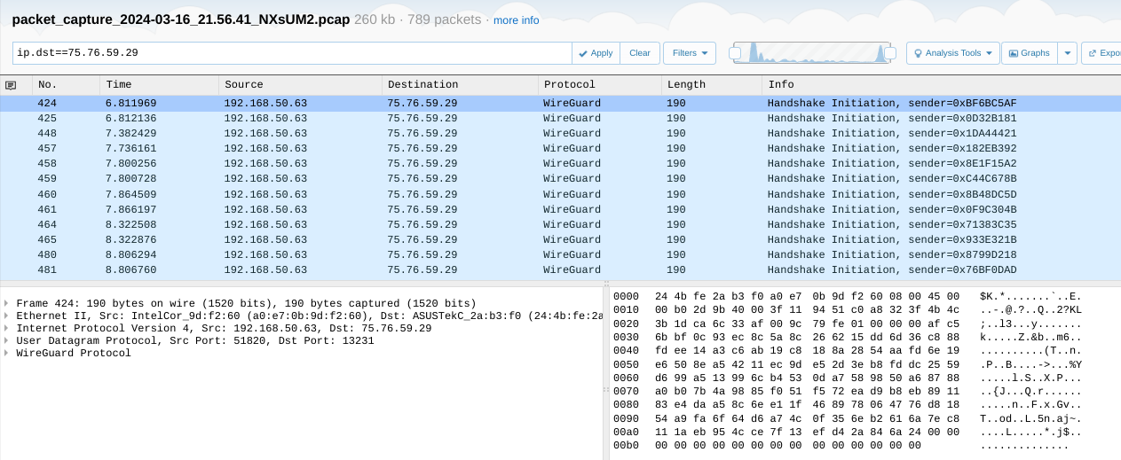

I am struggling to configure Wireguard on my home network, and was hoping to get a second (or multiple) set of eyes on the config.
Basic topology:
  • Home network with a physical Mikrotik router running RouterOS 7.14.1 and RouterBOARD 7.14.1
  • Test client 1 running on HP ChromeBook (ChromeOS) using the Android Wireguard client
  • Test client 2 running latest Android on a Pixel 7 phone
Issue:
Upon attempting to connect to the router via WG, the client logs “Sending Handshake initiation” over and over. No connectivity from client to the home network or the internet either via hostname or IP addresses (e.g. can’t hit 192.168.x.x or say dig @8.8.8.:sunglasses:. Packet monitoring and inspection is difficult on a ChromeBook at best, but I did manage to get a few packet captures that WireShark shows are essentially the same thing - a repeated msg about Handshake to the public IP of my home router.
I’ve been up, down, and sideways through this forum and others and am unable to resolve the issue. So I’m reaching out for help…

Packet Capture:
Note that the RouterOS Config has some cruft left behind from various other troubleshooting steps, but I believe that I’ve disabled all (or most) of the debris and am back to a stripped down config.
Any thoughts, comments, or inspiration would certainly be appreciated!

    protocol=udp src-address=192.168.0.0/16
add action=accept chain=forward comment="fwd LAN to WG" disabled=yes \
    dst-address=192.168.40.0/24 src-address=192.168.88.0/24
add action=accept chain=forward comment="fwd WG to LAN" disabled=yes \
    dst-address=192.168.88.0/24 dst-address-list="" src-address=\
    192.168.40.0/24
    invalid
    in-interface-list=!LAN
    ipsec-policy=in,ipsec
    ipsec-policy=out,ipsec
    established,related,untracked
    connection-state=invalid
add action=reject chain=input in-interface-list=WAN protocol=icmp \
    reject-with=icmp-network-unreachable
add action=accept chain=input dst-port=4443 in-interface-list=WAN protocol=\
    udp
add action=masquerade chain=srcnat comment="masq. wireguard" log=yes \
    log-prefix=wg out-interface=ether1
add action=dst-nat chain=dstnat dst-port=32400 in-interface=ether1 protocol=\
    tcp to-addresses=192.168.88.10
add action=dst-nat chain=dstnat dst-port=4443 in-interface-list=WAN protocol=\
    udp to-addresses=192.168.88.10 to-ports=4443
add action=dst-nat chain=dstnat dst-port=9098 in-interface=ether1 protocol=\
add action=dst-nat chain=dstnat dst-port=9099 in-interface=ether1 protocol=\
add action=dst-nat chain=dstnat dst-port=2222 protocol=tcp to-addresses=\
    192.168.88.10 to-ports=22
/ip service
set telnet disabled=yes
set ftp disabled=yes
set ssh port=22221
set api disabled=yes
set api-ssl disabled=yes
/ip traffic-flow
set enabled=yes interfaces=wireguard1
/ip upnp
set enabled=yes
/ip upnp interfaces
add interface=bridge type=internal
add interface=ether1 type=external
add interface=ether2 type=internal
/ppp profile
set *FFFFFFFE local-address=192.168.89.1 remote-address=*2
/ppp secret
add name=vpn
add name=client profile=*1
/routing bfd configuration
add disabled=no interfaces=all min-rx=200ms min-tx=200ms multiplier=5
/system clock
set time-zone-name=America/New_York
/system note
set show-at-login=no
/tool mac-server
/tool mac-server mac-winbox
/tool traffic-monitor
add interface=wireguard1 name=wg1-out
add interface=bridge name=wg1-in traffic=received
From:
/interface wireguard peers
add allowed-address=192.168.40.5/24 comment=ChromeBook interface=wireguard1
public-key=“xxx=”
add allowed-address=192.168.40.10/24 comment=Phone interface=wireguard1
public-key=“xxx=”
TO:
add allowed-address=192.168.40.5/32 comment=ChromeBook interface=wireguard1
public-key=“xxx=”
add allowed-address=192.168.40.10/32 comment=Phone interface=wireguard1
public-key=“xxx=”
Your firewall rules are a mess but I dont think that the issue.
