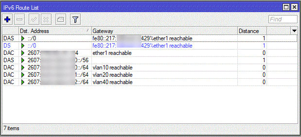

Following is my ipv6 routes pic that shows all the routes I am using:
Compare my ipv6 config against yours …perhaps it may help

You are using DHCPv6-PD client, that has always worked fine. I am talking about SLAAC, it is not the same thing. The DHCPv6 client is adding the default route you otherwise would not have. I’m talking about cases where you are not using DHCPv6 client.
Try disabling your DHCPv6 client. You will find that even though the address and routes disappear, that your router can still ping IPv6 addresses on the Internet even though it has no apparent global address or default route. It actually has both a global address or default route in this case, but it is like a secret hidden global address that it doesn’t show you, and a secret default route that it doesn’t show you.
