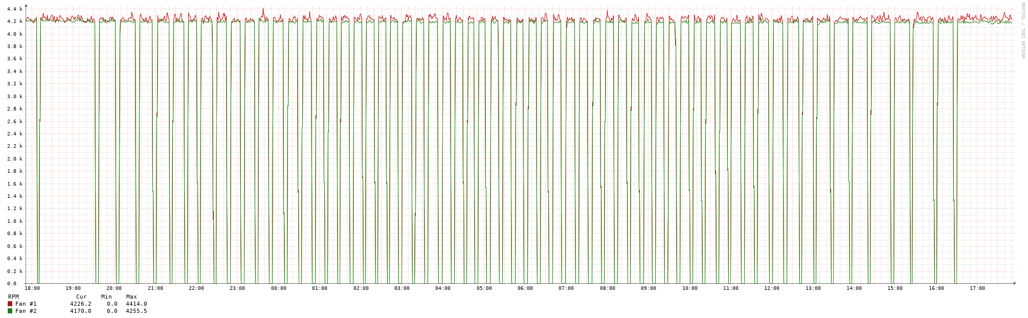

This is from CRS317 running 6.49:
Not a happy camper…
So, i would extend that request to the whole CRS line.
