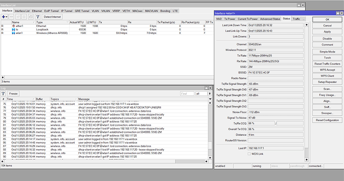

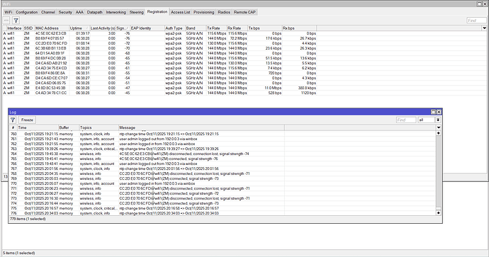

I installed SXTsq-5axD as AP, Wi-Fi receivers 4 (mipsbe) clients work. I connected 13 stations. During peak load, clients started to disconnect. AP shows signal -76, station shows signal -66. How to configure this device correctly? Maybe this is the problem of a hidden Wi-Fi node? Distance 2km.
config_backup_20251011.rsc (1.3 KB)
Logs in first screenshot say "extensive data loss". That could either be due to low signal levels (which is not in your case) or due to high interference ... which can be present only occasionally and thus hard to detect. It could originate from "a hidden node" or it could be from an unrelated source (another wireless network). In former case option "hw-protection-mode=rts-cts" of the legacy wireless driver would help, but I don't see this option for wifi-qcom drivers (and I don't know if this driver supports any of protection modes).
