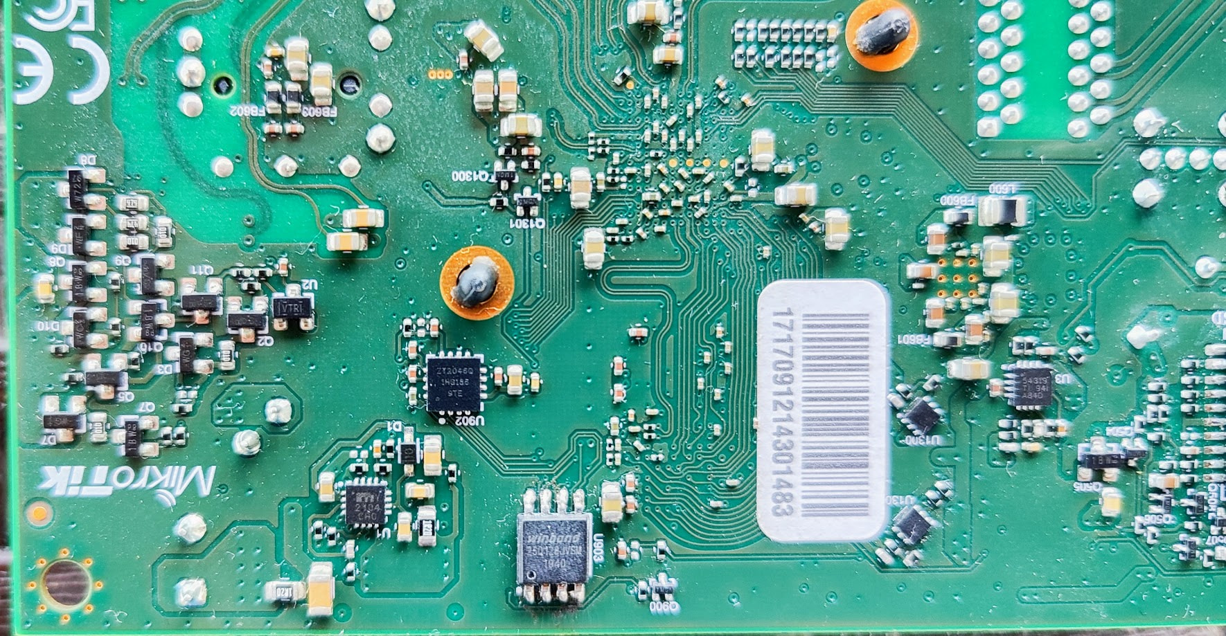

The flash memory is WInbond family 25Q128JVSM so its SPI programming and everything is stored here inside bootloader, checksums, second bootloader probaby etc. SOIC8 SPI NOR flash
So probably by my researches here the results
  1. bootloader1 (0x00xF000) — stage-1 (first-stage) boot code
  2. hard_config (0xF0000x10000) — serial number, MAC address, board identity
  3. bootloader2 (0x100000x1F000) — main, upgradable RouterBOOT
  4. soft_config (0x20000) — settings
  5. Remaining space — reserved for the RouterOS kernel/root filesystem once installed via Netinstall
