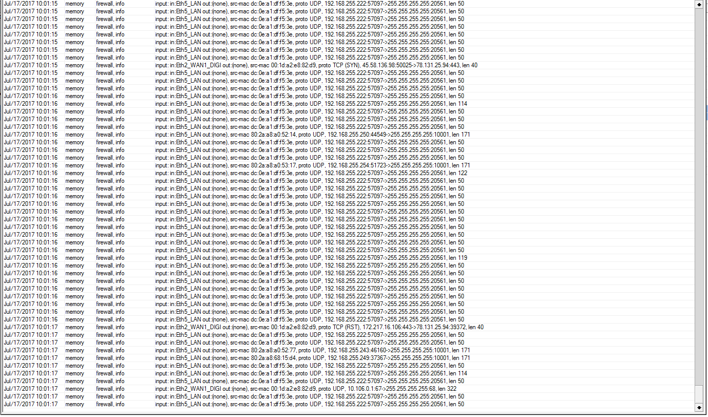

I did setup everything you’ve suggested, however I’ve discovered an other interesting issue.
The router doesn’t respond to PING requests, and DHCP doesn’t work; if I use the ping command from the router to the end device, than the end device is suddenly capable of responding and the connection comes alive. This is true for both DHCP and STATIC configured devices on my network.
Any suggestions?
*Edit:
Other interesting thing is, that the addresses handed out from my DHCP pool seem to arrive at end devices, but with a wrong netmask.

I sort of have no idea what the issue is.
The interfaces are connected to the proper physical connection, ARP is enabled.
DNS doesn’t respond to requests until I ping a device from the router. DHCP should work, but it won’t route, it will just hand out addresses on the LAN and that’s it.
Could this be something messed up in the firewall?
I attached a snippet from my log, DC0EA1 is my admin machine, and the rule we are logging is “Drop all else input” chain rule.
Maybe its because the connection is not counted as established/related until the two devices communicated once? Even than, DHCP, DNS and UDP are allowed on both TCP and UDP in-interface: LAN.
Regards,
Imre_K
*EDIT:
Edited my previous post to include most recent config.
This sounds like you have ARP disabled on the LAN interface.
Go into the settings and make sure ARP is set to enabled, or reply-only (only use the second one if you’re trying to force DHCP use, and have add-arp=yes in the DHCP server settings)
As for DNS, under your settings, you’ve configured allow-requests=yes, but assigned the Mikrotik’s own internal IP as the server. This is the problem. That setting is the one the Mikrotik itself uses as a DNS server. It’s NOT the server assigned to clients. Change that to whatever DNS server(s) you should be using with your ISP, and that should fix the DNS issue.
