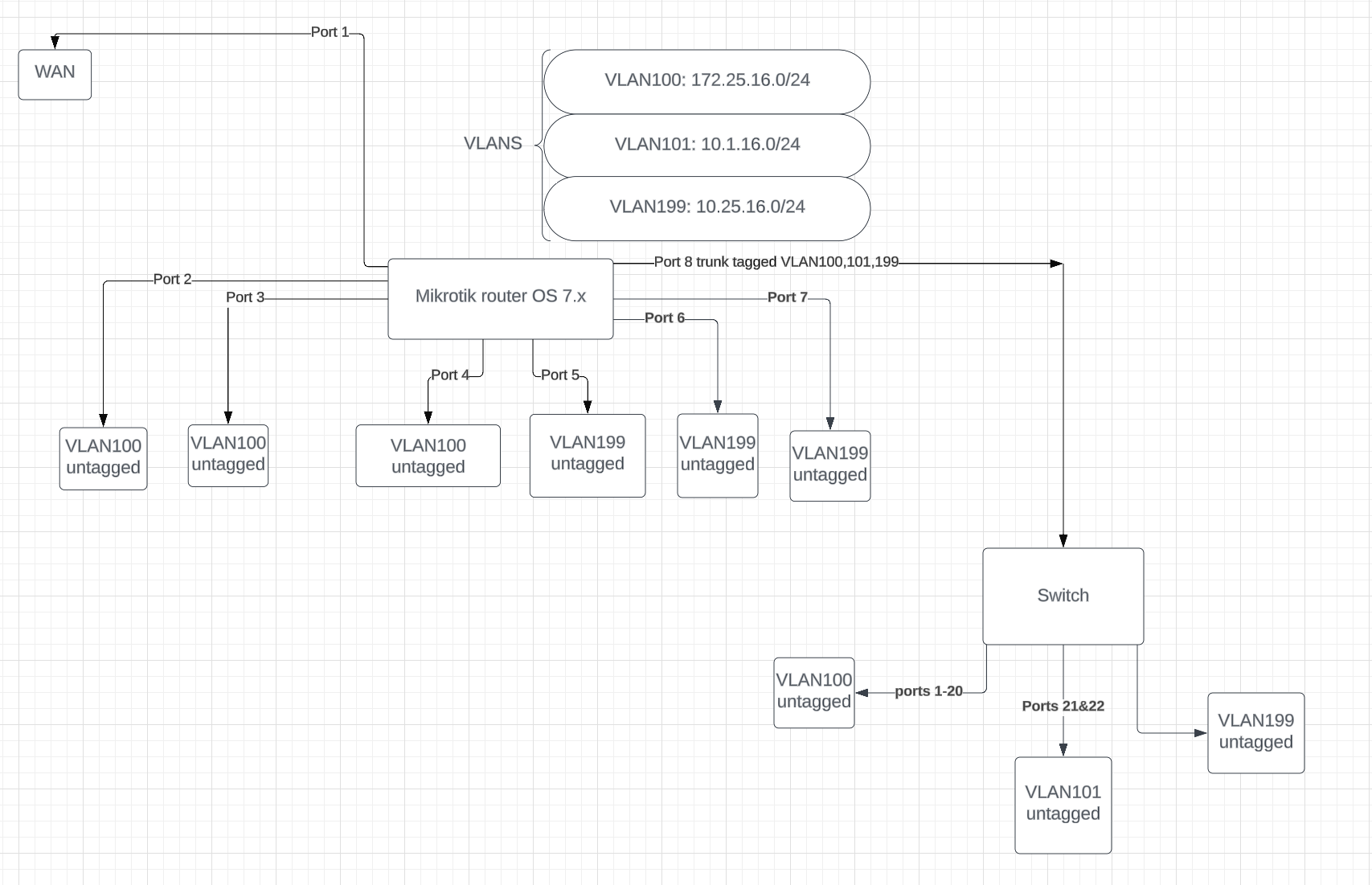

Hello people on the Mikrotik forums,
We have issues setting up a Mikrotik router for a configuration as in the attachment overview.
We are quite new into Mikrotik and are struggling through the documentation.
However, we can’t find a correct way setting it up like we want to.
A lot of documentation is also for router OS6 instead of 7.
We have it running with the tagged trunk port to the switch, but we can’t get the tagged/untagged combination to work.
Could somebody enlighten this configuration for us?
Thanks in advance!

Which part doesnt work the router ports or the switch ports and if its the switch, you failed to mention which router model or switch model??
The router model is RB5009UG+S+(arm64) and the switch is an aruba instant on 1930.
when we connect a machine on the switch on either a100 or 101vlan port it recieves the proper IP adress corresponding to the respective VLAN’s,
except for when we turn on “VLAN filtering”
but for example a machine connected on the switch on a VLAN100 port is not able to ping a device directly connected to the router on a VLAN100 port.

i used this usefull thread viewtopic.php?t=143620 to get it to this point so far, i will look at the other link as soon as i have time aswell.
add name=bridge-all pvid=100 vlan-filtering=no
Should be:
add name=bridge-all vlan-filtering=yes
Frame-types should be set on the /interface/bridge/port

maybe it would be good for me to explain that i am really quite new in the world of networking and this is the second router i have attemped to set up, and the first time i have worked with a mikrotik router and VLANS. So i am sure this is not a problem with any of the documentation or information avaliable. it is just me not having very much knowlegde and slimply misunderstanding things, and not fully understanding yet all the proccesses wich are needed to make setups like these work
i think the reason this line is like this is because i did not do this trough the terminal, i did it with the winbox interface and when you check the box for “VLAN-filtering” it automatically puts in PVID:1 wich confused me since i dont really know what a PVID is for nor is it mentioned in the article. and since it didnt work with 1 as its PVID that i thought i might have to change it to one of my vlan ID’s to make it work perhaps.
in any case, after changing the config line to the correct one
i am still not getting an Address from the router unless when i uncheck the “VLAN-filtering” in winbox interface

I only address here the vlan part. The problem with your config was that you did not include the bridge itself as a tagged “port”.
Because you are “tapping” into the individual vlans, the bridge(cpu from the switch logic) is also a virtual port that needs to “pass” tagged traffic

Thank you! the problem was indeed that i did not include the bridge itself as a tagged “port”, after testing and confirming things worked the way i would like them to i did enable ingress-filtering=yes
on all the bridge ports.
also big thanks to Erlinden and Anav for the clarification and patience.
