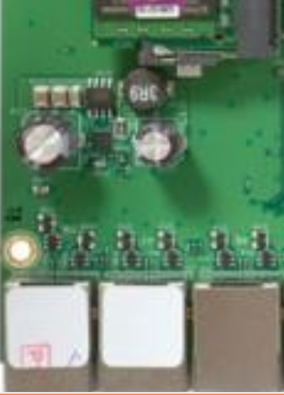

Now, there is some hiss noise coming from the RB (high frequency noise) once powered on and on load this noise increases in strength. After opening the RB I found that this noise originates from an SMD conductivity component found next to two capacitors where the RAM module is located. This component has the labeling 3R9 and I assume some issue with it, so I would lieke to replace the same.

From the notation, that is a 3.9 Ohm resistor.
In this case there is now Need for exchange an resitor, change this two caps nearby
Interesting. If true, can you think of any reason why it creates this noise? Picture attached.
Caps for Filtering , they Filter Frequency and if they are Not working you can Hear this
But resistors Not often Makes Noise, It is often an coil whitch makes the Noise
By “Caps” you are referencing to the two capacitors? If yes, I have already thought about that and replaced them, however the issue remained. The reason why I believe the issue is with the resistor is because once I press it lightly with my finger, the noise stops. But I believed it to be some SMD conductivity component..
It might be an inductor (3.9 uH) but if the noise is the only problem I wouldn’t be worrying much about it.
https://www.eevblog.com/forum/projects/hissing-inductor-cores/
Quick google search also gives this result http://www.techtrans.com.tw/smd_power_inductors2.html?CID=7
however only Mikrotik knows exact specs so you should write to them directly (support@mikrotik.com).
Regards,
M.
Thank you for confirming that it’s a SMD power inductor. I will check with MikroTik about the same.
If the Noise stops by hitting it use clearcoat or glue, then the Noise ends
After seeing the picture, it is certainly a 3.9 uH inductor, and that module looks like a switching DC/DC converter…
Check on page 3 the one with code 3R9: http://catalogs.avx.com/SMD-PowerInductors.pdf
Try the glue tip :slight_smile:
Thank you. I’ve got a reply from MikroTik support as well and after providing the serial number of the RB, they kindly followed up with this info: “It’s an Inductor 3.9uH 20% 4.5A 8.3x8.3x4.5 19mOhm Manufacturer code: BCRH8D43-3R9M-NL”. I will think about what to do next.
