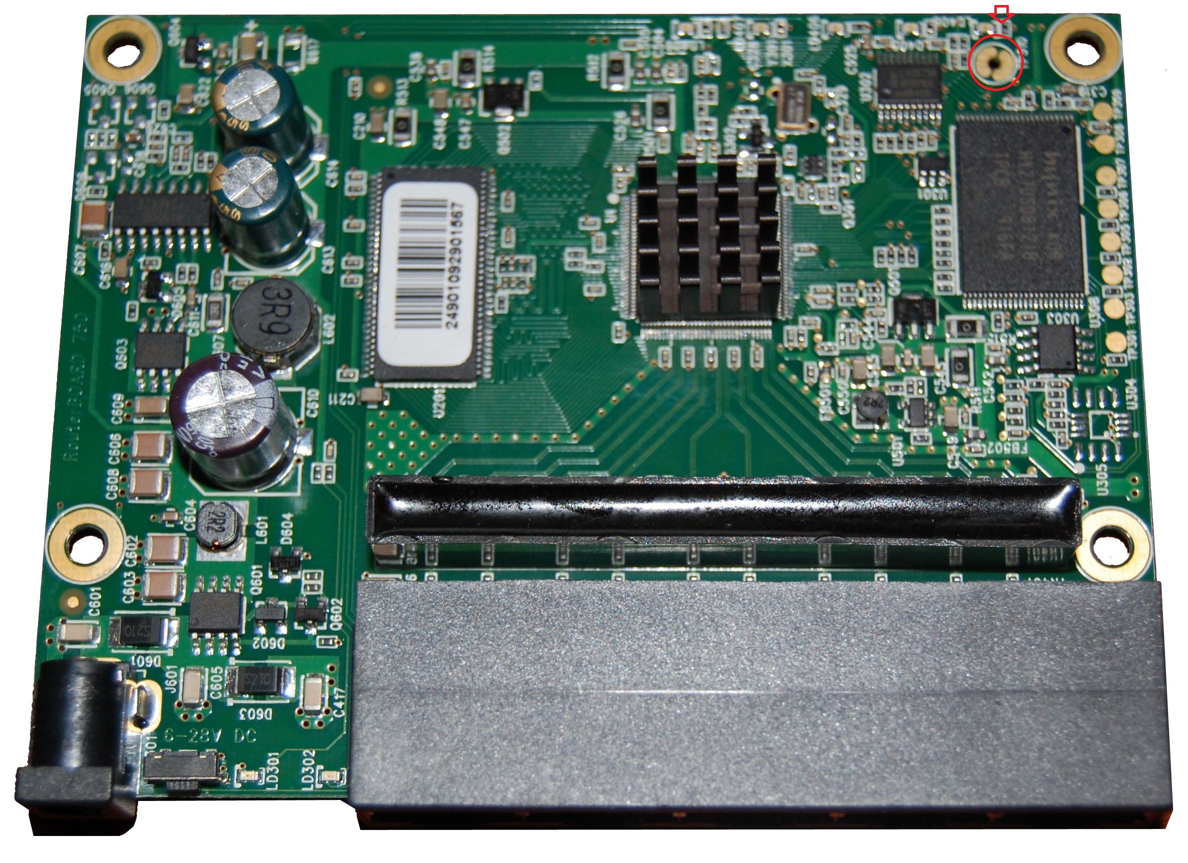

normis, I tried to reset the rb750 as you instructed above, but i could not find the reset-hole, but saw a jumper with 2 pins… can you show me the right place to reset (rb750 board picture). that will help me know exact place to reset.
Thank you
the hole is on the top-right side in this picture, right above the Hynix chip, to the left of the mounting hole.

There is no need to open RB750’s case - the discussed reset hole can be found under one of rubber feet on the down side of the device.
normis, i tried the small hole, but is still not working. I circled the small hole on the picture that i short circuited… remember, by board is rb750g so there is little difference with your rb750.

you don’t need to solder anything, the circled hole is the correct one, and it always works. see this:
http://wiki.mikrotik.com/wiki/Manual:Password_reset
