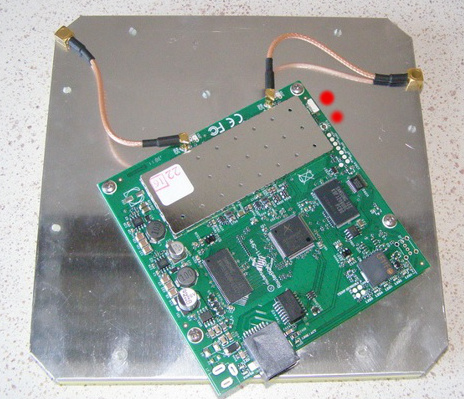

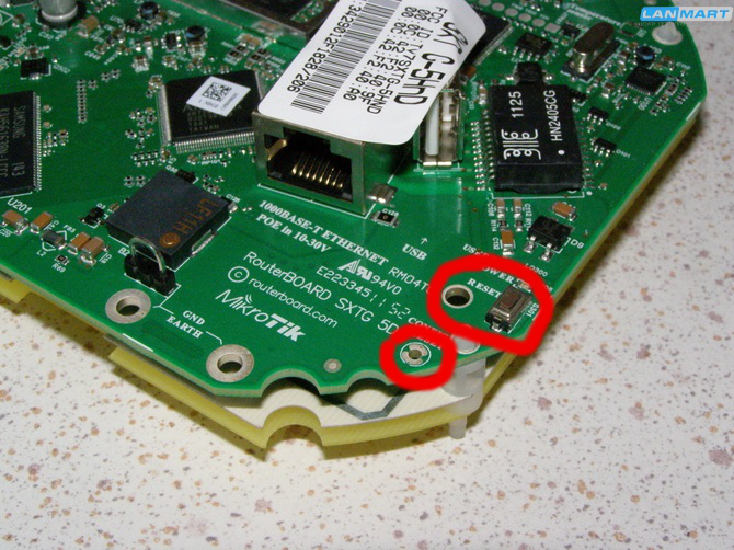

Hello, look at this picture (the red circle) see you there a reset button. Push a 20 seconds on it
Ore the other circle short this with a screwdriver ore something.
Caution this is a picture from sxt but sextant must the also have
Can you see this on your sextant?
If you can login by “system” can you click on reset configuration.
I read just that sextant use a routerboard 711
I think that the reset button are on the right site above
http://www.lanmart.ru/blogs/mikrotik-sextant-open/
Yes, in SEXTANT, the reset button is located inside the unit, you will have to open the antenna cover to get to it. We will improve this in next designs.
