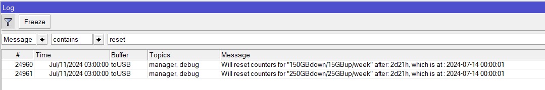

when creating limitations on Usermanager>>Limitations>> add , there are reset counters interval and reset counters start time drop down lists. you can set your own values.

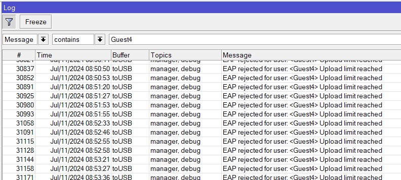

Reset counters in "Limitations "does work. I could not find the counter values, but users are actually stopped by Profile Limitations until reset executes.
Reset execution is visible in the log.
These are NOT the counters in the Users TAB page !
Limit counters , hard deny, values not visible
But reset works
