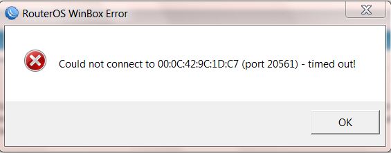

No joy with this. Can’t get any response via serial connection (although I have no modems any more to test that the cables are working - that will be tomorrow) and the mac address connection simply comes up with an error - as per the attached file.
Problem solved ! It was the delightful Windows 7 OS on my laptop :frowning: . When I booted it to XP I could connect no problem via the mac address & winbox.
