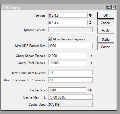

Thanks for your replies! In IP/DNS, I have :
How can I set Mikrotik as DNS resolver? Also, should I set mikrotik as DNS resolver ? :slight_smile:

Whether or not your devices use the Mikrotik as their DNS server depends on how they’re configured. Easiest way to configured this is normally to configure your DHCP server to give out your preferred DNS server. If you’re using your Mikrotik as DHCP server as well, then this is configured in Winbox under IP / DHCP Server / Network. Set DNS Server to be the IP address of the Mikrotik
And your second question, yes it’s a good idea at least in my opinion. Apart from being able to configure local names like we’re discussing here there is also the benefit that the Mikrotik caches the names it resolves, so regularly used names don’t need to be looked up from the Internet.

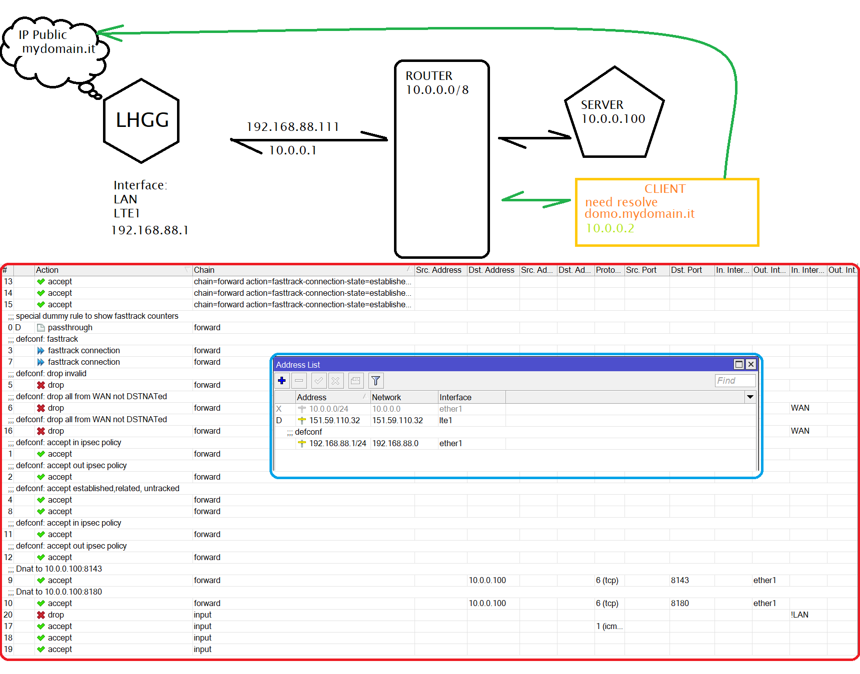

I’m resurrecting this discussion because I have a similar problem… I have to access my domain with public ip from inside my lan, ngenix redirects https calls to my server: 10.0.0.100
From the outside everything works fine, from inside my network it doesn’t :frowning:
Any suggestions?
Again and again … It’s called Harpin NAT
http://forum.mikrotik.com/t/loopback-nat-or-hairpin-on-mikroitk/162786/9
http://forum.mikrotik.com/t/forward-internal-traffic-to-internal-webpage/160853/3
http://forum.mikrotik.com/t/cannot-access-wan-ip-from-lan/161858/2
or https://forum.mikrotik.com/search.php?keywords=mikrotik+harpin
https://forum.mikrotik.com/viewtopic.php?t=179343
