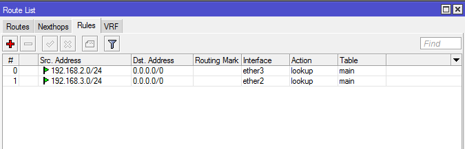

The route that i make is attached below!
See and let me know how i can resolve…

PS: Now i attacched the route that i create…
After when you finish apply to added ip route between to routers. And 3.x cant ping in to 2.x

Remove bridge interface (and set “none” in master port in all port), assign the address (IP->Addresses), set dhcp, one for each ports. In routes, click on the rules and add a new rules than the source addr. of the network in the first port, in dest. address set 0.0.0.0/24 (all ip), then in interface set the ethernet port of the destination network. i already set in table “main”.
Make another one rule for the viceversa.

Good job getting things rolling - but one thing to point out - you don’t need the static routes with dst=0.0.0.0/0 or any route rules.
The router will naturally know which interfaces it should use to forward traffic for the locally-connected subnets.
