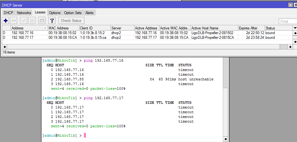

What puzzles me is that I can see ARP and IP packets from the far end of P2P wireless link (192.168.77.79), I also see SSDP packet from the near end Propeller (192.168.77.16) but I don’t see any ARP requests or replies form the Mikrotik side. Obivously, I aslo cannot ping 192.168.77.79 regardless of the presense of ARP packets. It seems like Mikrotik just doesn’t answer ARP on that port. However, it’s explicity said to answer ARP. See screenshots as well.

2016-06-28 19_51_35-admin@192.168.77.88 (MikroTik) - WinBox v6.35.4 on RB751G-2HnD (mipsbe).png

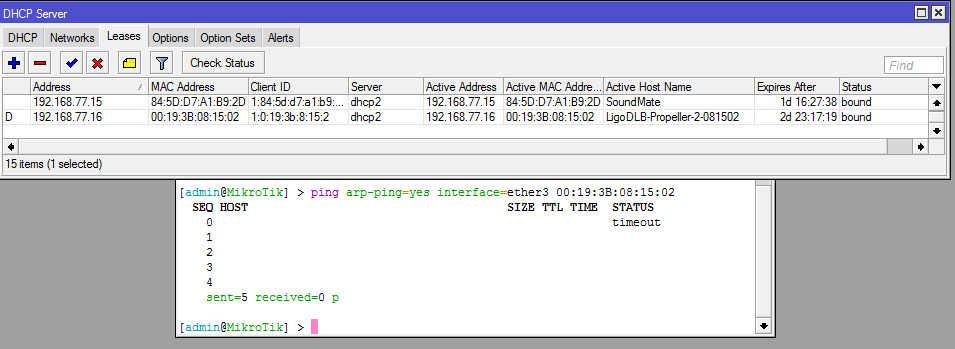

In the meanwhile I did a fresh packet capture. During packet capture I did ARP ping which failed. Refer to the screenshot.
However, packet capture clearly says that Propeller sends back ARP replies to Mikrotik. For some strange reason Mikrotik doesn’t want to accept this ARP reply and install in the ARP table
2016-06-29 12_43_14-admin@192.168.77.88 (MikroTik) - WinBox v6.35.4 on RB751G-2HnD (mipsbe).png
2016-06-29 13_10_30-admin@192.168.77.88 (MikroTik) - WinBox v6.35.4 on RB751G-2HnD (mipsbe).png
