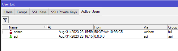

The other problem:
I see that connect via REST API is lack of changed policy.
Steps to check:
  1. Create user for API and its group with full permission (or must have read+sensitive permission).
  2. Connect to device via REST API and do something like listing users in user manager and see that sensitive data such as password must be shown.
  3. See System > Users > Active Users and you will see that “API” user still exists.
  4. Change group policy for this API user to not showing sensitive data or just no policy at all and apply.
  5. Try to connect via REST API again. You can still see users in user manager with sensitive data (password). This is the problem! This user (API) should has no permission to list anything.
  6. Check again like step 3 and you will see that that user (API) still active and it seems there is no way to kick it out or force log out. You have to wait for a while until it is automatically log out.
RouterOs v7.11

Yeah I was guessing 1 minute… but seems it’s 10 minutes off before cleared (and thus allow re-checking of access/policy).
It worse than just policy, since even if you disable a user… you can still make REST calls if within the 10 minute cache window. This part is pretty unexpected (even if explainable).

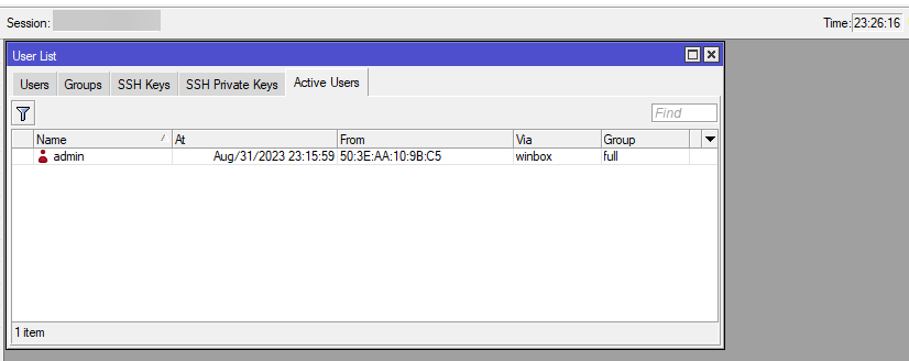

To be clear, I did confirm it does re-check creds after 10 minutes from the first REST call that created the active user. Why your times are appear variable.
So if you look in “Active Users” at the “At” time, it will recheck +10 minutes from that. Usage does not change the time – it from the first REST call without an existing active user.
Yes, you are correct. It spend 10 minutes to make active user disappear.
