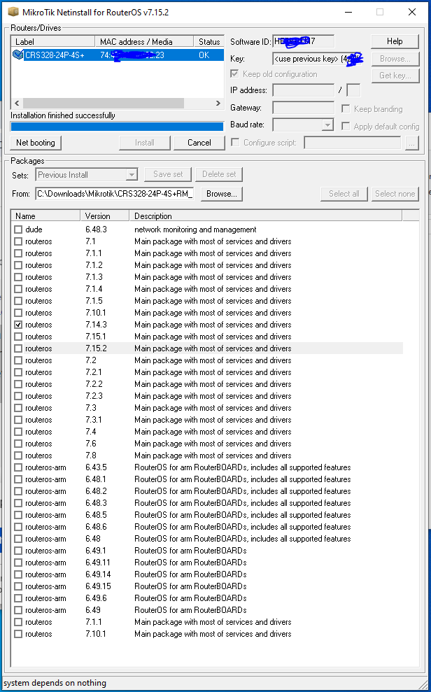

I set my laptop’s net interface card IP address to 192.168.88.2, subnet to 255.255.255.0. gateway to 192.168.88.1, I tried to use different versions of netinstall, but my switch did not appear in it. After many-many attempts, netinstall-7.14.3 could recognize my switch.
Of course, I tried the latest routeros-7.14.3-arm.npk to install. Without any success.
Many reboot, many netinstall attempts led to install routeros-arm-6.48.1.npk successfully. Again: in console mode with Netinstall, it was the latest version what I could install.
I had to use console config ‘o’ to set ‘n - boot from NAND, if fail then Ethernet’ to prevent continuous attempts of booting from BootTP.

Wen newer ARM version of 7.15.1 appeared I did a not so smart action: I tried to update my CRS328-24P-4S+RM switch to the latest routeros according to guides. To be honest it was a stupid action.
Why did I have to poke a device that I brought back from its death? Why wasn’t I satisfied with what I had already achieved? Perhaps it was my own arrogance, perhaps my trust in the Mikrotik Company. I was wrong.
It did not work.
Console view stops at “jumping to kernel code”.
I have already tried to install all of available previously downloaded routeros versions from 6.43.5 to 7.15.2 via Console+Netinstall without any success.
