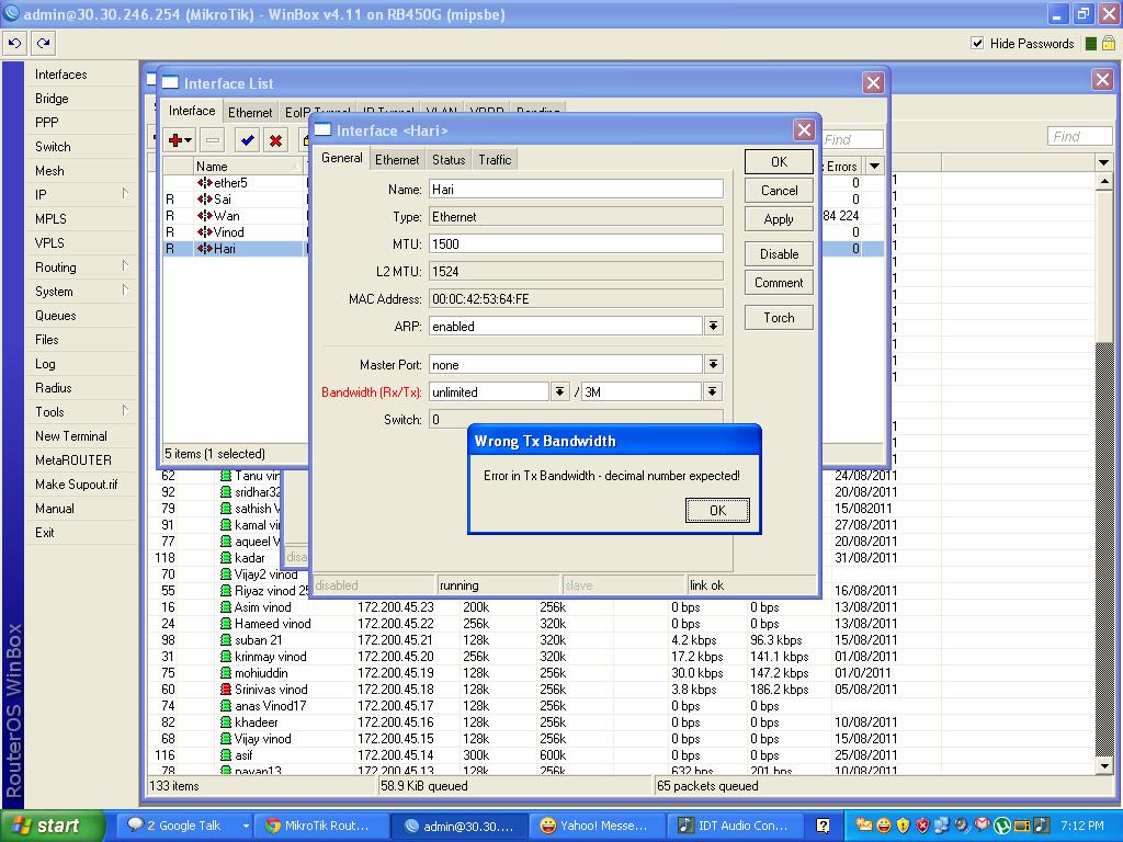

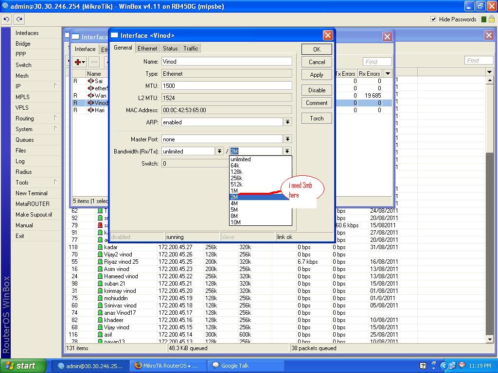

I am using 450g for bandwidth restriction already i have restricted 2 mb on one Ethernet which is in the list of Bandwidth (tx/Rx) and on the same Ethernet i want to restrict to 3 mb but there is no 3mb option available in list give any solution to restrict 3mb on the Ethernet .i have attached jpeg

I have tried to put manually but the error is coming like this i have tried a lot
This is hardware feature of this board and 3M value cannot be supported.
