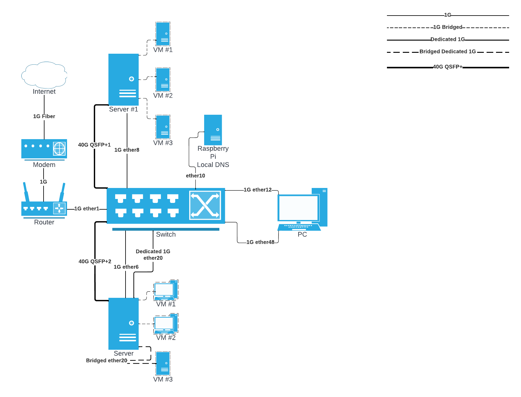

Network currently looks like this;
Internet <-> Router <-> MikroTik C​RS354-48G-​4S+2Q+RM <-|
                                                       |->|Server #1 Proxmox 6.4-13
                                                       |   |->VM #1 Ubuntu 20.04
                                                       |   |->VM #2 Ubuntu 20.04
                                                       |   |->VM #3 Ubuntu 20.04
                                                       |->|Server #2 Proxmox 6.4-13
                                                       |   |->VM #1 Windows 10
                                                       |   |->VM #2 Windows 10
                                                       |---->|VM #3 Ubuntu 20.04 (testing vlans/ip camera handler)
                                                       |       |-> Dedicated 1G NIC for vlans, to simulate an IP camera
                                                       #Planned
                                                       |-> TP-Link TL-SG1005P (poe switch) -> up to 4x ip cameras
I intend to have the Mikrotik switch function as the router, however that has to wait until I’m moved out this weekend.

Can you provide a network diagram of the Topology ?
And export with hide-sensitive the configuration of the CRS… Also manually remove serials, Public IPs etc if any visible on the config export…
As requested, I put together a network diagram and exported the switch’s config. See attached.
Edit: The folks over on the Homelab discord helped me figure out the issue. My tagged section in the vlan table needed to include the bridge itself. Once I did that and switched my vlan interface back to the bridge, the clients immediately grabbed DHCP. I attempted to connect to my main local subnet via one of the vlan clients and was unable to. I didn’t add any filters or firewall rules, I assume this is because I never added a route to that subnet.
