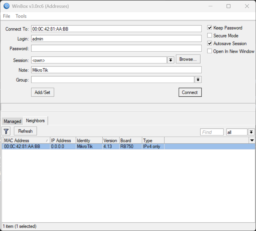

In WinBox it appears like this, with IP 0.0.0.0 :

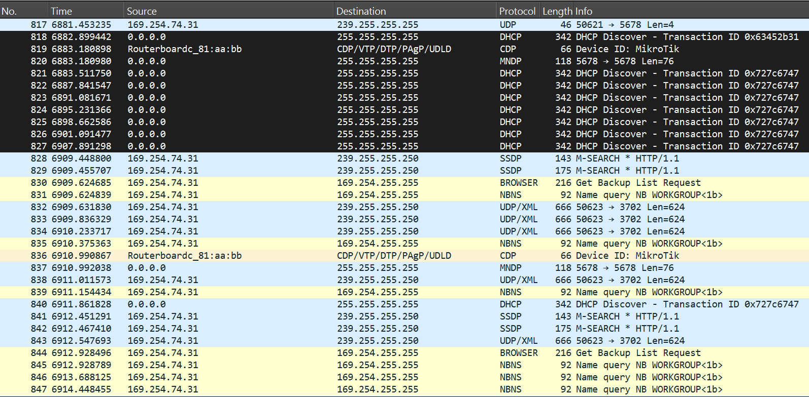

I connect my PC to Port 2 and looked at WireShark messages:
Any idea on what can I do in this case?

Using MAC address, user=amin, passwd=, doesn’t work ?
Since it shows uptime in Winbox, it is doing something and communicating.
Maybe Winbox 3.41 is too new for that thing ?
You don’t happen to have much older versions of Winbox around to try ?

On the winbox screenshot, everything is set-up to click connect (when connect to is filled with MAC address, winnix will try to connect without using IP).
But there are a few problems:
  1. ROS version is extremely old, your winbox can’t connect to it due to change of how password is communicated. You’d have to use winbox version below 3.19 (or something like that)
  2. ROS version is extremely old, you shoukd install something way newer. But due to bullet #3 perhaps stay with ROS v6 (6.49.18). Due to extreme version difference you should upgrade in steps … AFAIK there was efen change in license format … and upgrading only slightly did convert license to new format. Quite posssibly directly installing a contemporary version wouldn’t do it properly.

I downloaded old WinBox v3RC6, but when I try to connect I get WRONG PASSWORD.

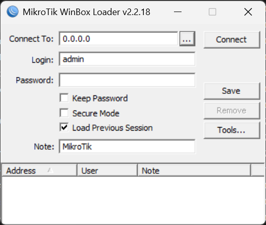

With WinBox 2.2.18 I get this error when trying to connect.
It might be that this router in particular have customized firmware? DIGI is a Cable TV Company in Romania . . .

3.0 RC6 Is from 2015, so maybe still too new?
Can you try to connect with v2.x via MAC? (of course It cannot connect via IP to 0.0.0.0)
So I tried connecting with WinBox 2.2.16 via MAC address, but I get WRONG PASSWORD if I lease password field empty.
Same WRONG PASSWORD I get when I try connect with WinBox 3.0 via MAC address.

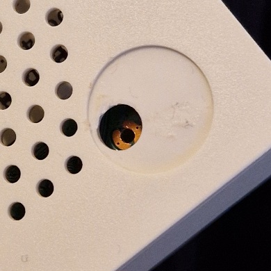

I found another think that might help, under one of the rubber feet, there is a hole and in the hole there is a jumper.
I did try to use it and do a Router OS reset, but unsuccessfully.
What is the procedure using this jumper hole?

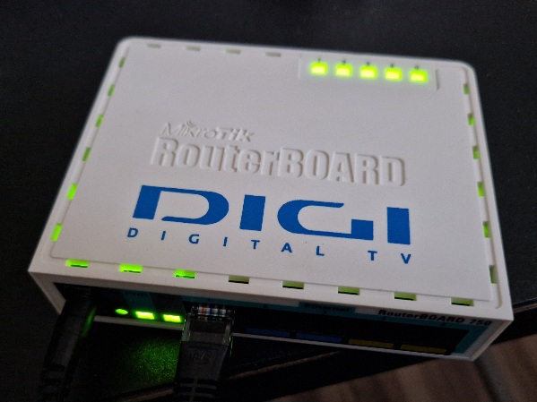

Also, somehow I was able to make te router looking like this, with all LEDs turned on:
Does this mean anything?
The reset pad, which you discovered under ruber foot, has same function as reset button. So keep those pads shorted while applying power (and then for a while more) until netinstall starts to show signs. From own experience I can tell you it’s hard to keep pads shorted and plug power at the same time … for me, a Phillips screwdriver (with + shaped head) was better than flat one.
You may have managed to short pads while device was powered … so you may have succeeded in reseting device to defaults (in which case username is admin and empty password).
That contact is the same as the (possibly defective) reset button, use a cross (Philips) screwdriver to make the short.

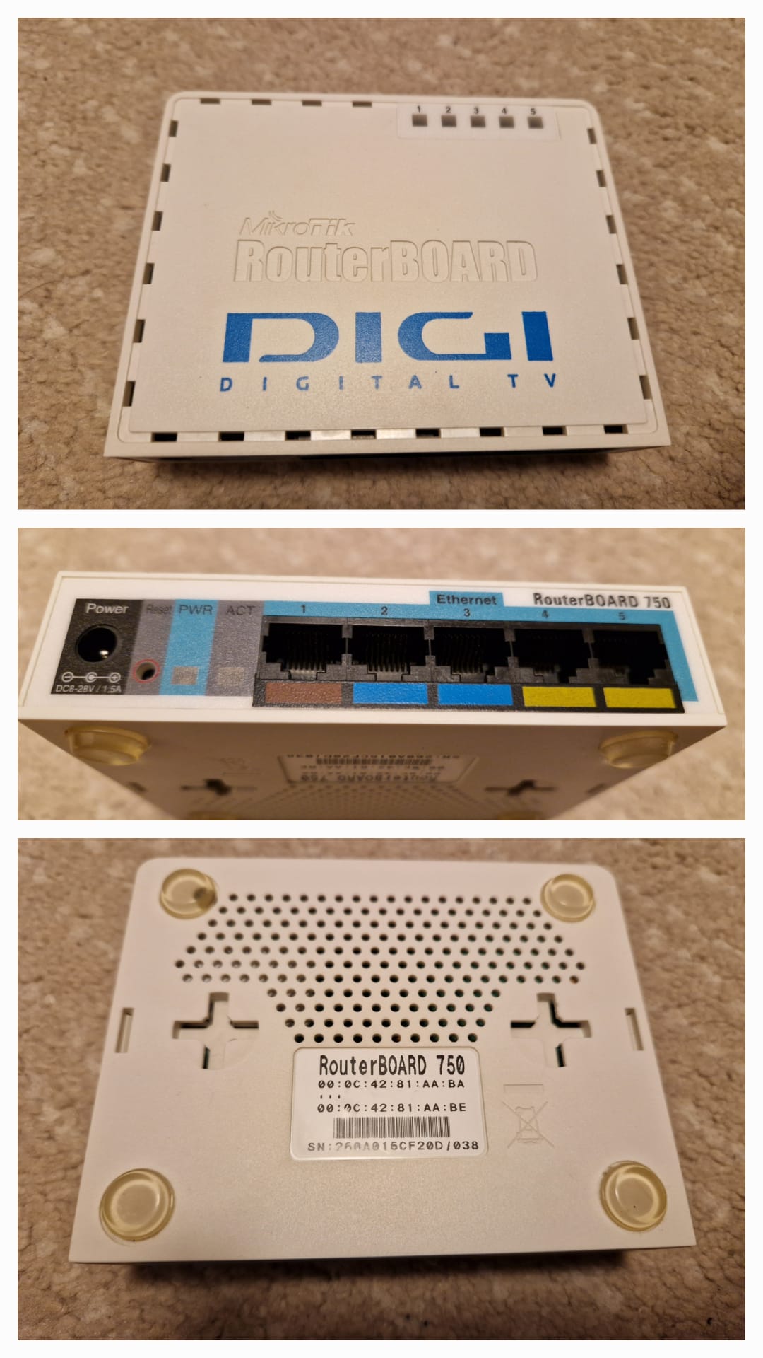

What is the problem?
There are two “clamps” visible on the picture of the bottom between the edge and mounting crosslike holes.
Just loose that clamps with a pocket knife or flat screwdriver and pry the cover.
Instructions from Mikrotik (for hap lite, but case is the same).
