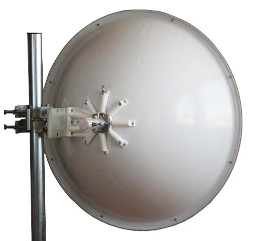

You will need good dish-type antennas. Maybe you can try grid’s, but I’m afraid that result will be worst than with dishes.
If I have to make such link, I will use
Jirous 32dB
or
DISHETER DUO28 BOX
Foar a card:
DBII F52N Pro
or
SR71-A
And for the board I will use RB411AH

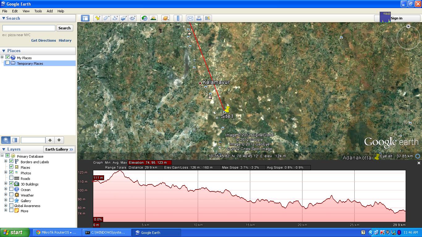

sitesurvey details
  1. The site with 110 m elevation has 27 meter tower from the ground
2.The site with 74 m elevation has 33 meter tower from the ground
Here with i have enclosed the sitesurvey details of the proposed project with tower height. I’m not much familiar with fresnal zone but aware of that. So friends pls analyse and give me the suggestions and
is it really feasible to establish the link
Use http://www.ligowave.com/linkcalc/ which is free, to calculate fresnel zone clearance and estimated signal levels and fade margin
LigowaveLinkAnalysis5ghz.pdf (102 KB)
OK you have fresnel zone issue with vertical try horizontal polarization and in most cases TX power should be 25dbm
