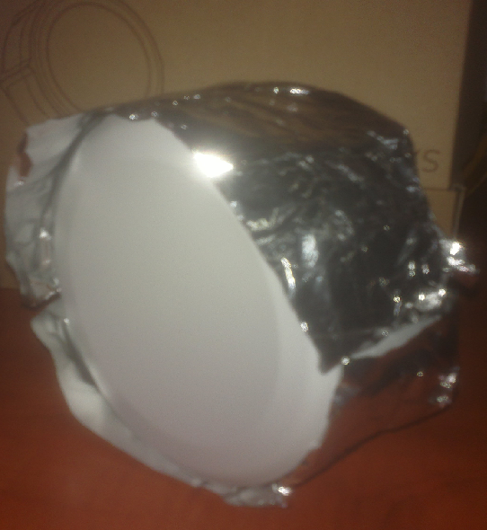

So basically shielded SXT should look something like that :smiley:
Just adding aluminum foil should increase SXT back and side sides resistants to interference
This is outside RF screening only, you also have to screen the board and radio card from the internal antenna.

Shielding like you show above (with foil) doesn’t decrease self interference, it only increases it, because it makes reflections, and signal bounces around inside the shield. Without the shield, this will not happen. This is why professional shielding will absorb the signal, not reflect it.
Picture above was more like a joke
