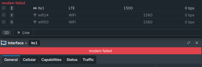

The main issue is that the modem is failed and the lte1 interface is unusable.

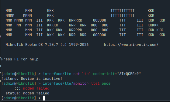

If I try to get the status of the device from the terminal I’ve got this error:

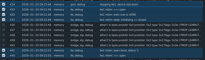

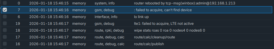

I’ve also enabled the debug log and it seems to unable to find the device…

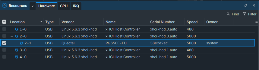

…but it still appears on the resources:

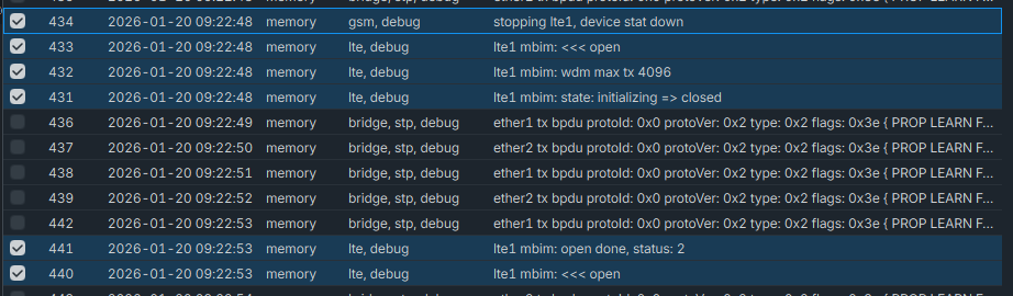

thank you for your suggestion but I still get modem failed with those messages logged:

I’ve tried the command but I’ve got this error from the terminal
IMG_006931_2026-01-25 22_45_23 - admin@192.168.1.160 (MikroTik) S53UG+5HaxD2HaxD&RG650E-EU WinBox
