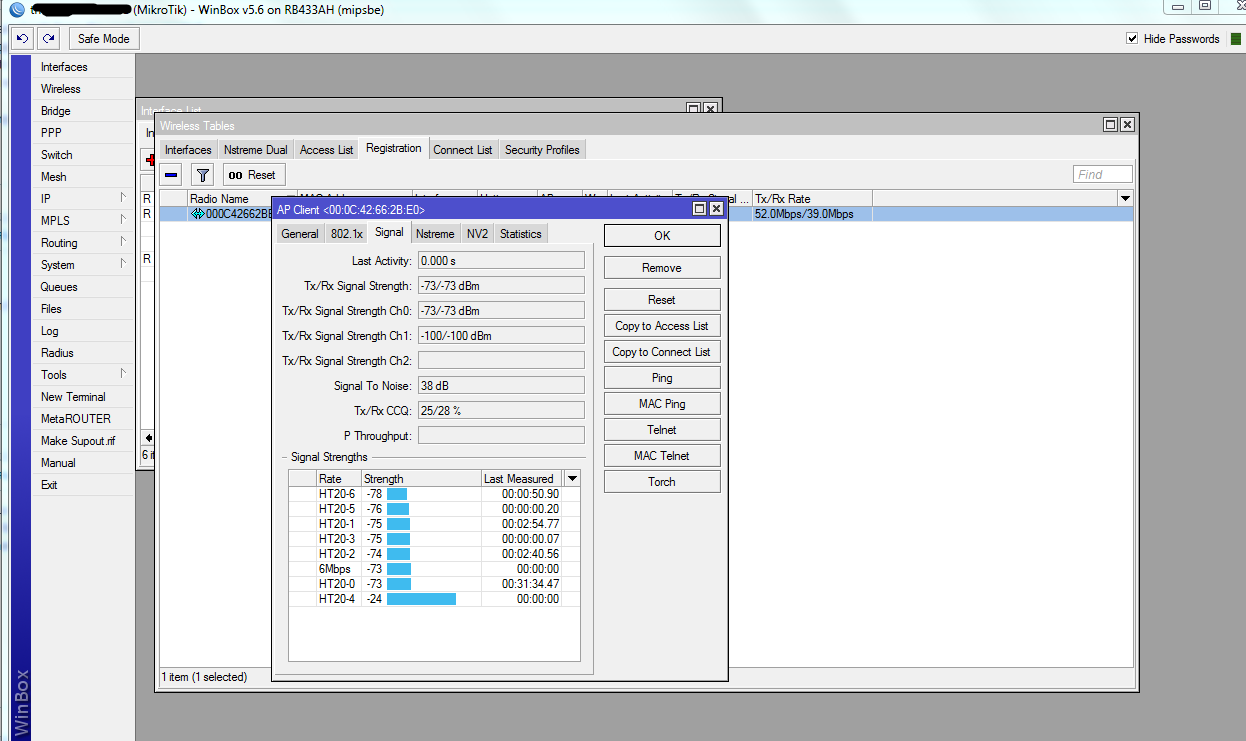

The CCQ is quite low 20/20. I think this is why the throughput is low. How can i increase it?
So this is in registration.
I dont know why HT20-4 has spikes like that one. The others are pretty harmonic. Also what is the Signal Strength Ch.1 and why is it -100/-100 dbm?

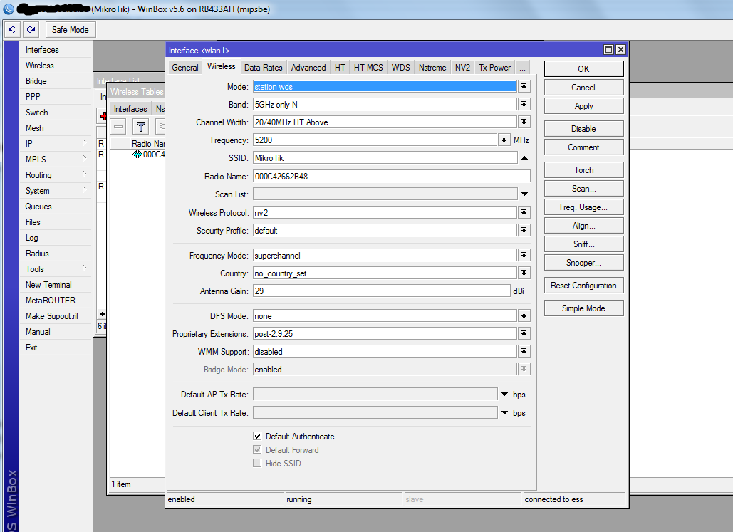

This is the configuration in wireless
use:
frequency-mode=reglatory-domain
country=[your country]
then tune antenna-gain (i.e. set to 0)
you have problems in ch1: -100dbm indicates a broken radio, a broken calble or something wrong in antennas
you must obtain at least -64dbm
a low ccq (when there is traffic in interface) could indicate you use a busy frequency: use frequency scan to see if there is a free one
it seems you use 5200mhz (but we see the station side): if yes, antennas you use are built for this frequency ? or they have too much vsvr at this freq? try to change frequency
try to use ‘nstream’ in bridge and ‘any’ in station and see if ccq improves (when traffic pass in the interface)
