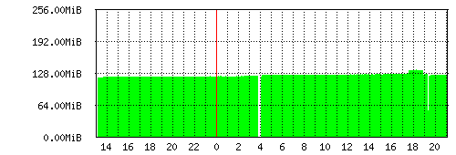

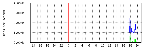

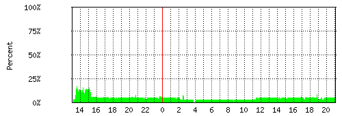

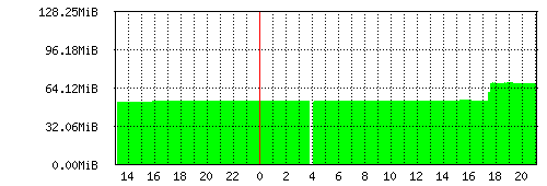

You can see my probe running here. I’m also attaching some screenshots showing how my hAP ac³ is handling the load (it doesn’t make a dent lol).
