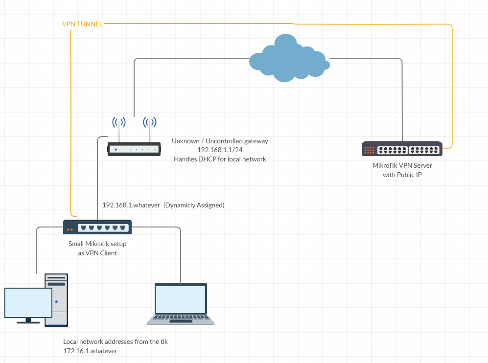

I am trying to setup a Tik to act as a sort of VPN gateway for local clients. It would be plugged into an existing local network (like at a hotel), any devices that plug into the Tik (or connect via wifi) will be routed through a VPN connection to the remote corporate network (also a Mikrotik, sitting on a public IP), no client configuration needed on the devices.
The VPN server is already setup for l2tp/ipsec however I can also enable any protocol that will work (eoip?) as long as the l2tp connections continue to work.
I am guessing I just need to setup the VPN Client in the Tik and then route all traffic through that VPN interface, I have found guides on how to do that. But as the Tik will sit behind an uncontrolled NAT firewall how do I best set this up to that the tunnel gets through and I don’t cause any issues like routing loops?

I tried routing the VPN IP to ether1 but did not work. I was unable to ping the address from the tik and the l2tp tunnel would not connect. However if I specified the local LAN’s gateway address then it works. Problem is for this setup I my not know the gateway address (and don’t want to have to manually set it even if I did). Why can’t I just push it out that port and let whatever gateway on the other side handle it?
Also is it possible to grab a DHCP address from the far end (corporate network) so I don’t have to deal with NATs?

However, I thing there is some confusion regarding my question. I am familiar with routing, my issues is getting the Tik to use the interface (or the IP learned via dhcp through that interface) as the gateway. One of the objectives of this project is to have this router form a VPN tunnel WITHOUT any prior knowledge of the local LAN. I know its possible from a networking standpoint as I have seen other devices that do it. The question is how to do this with a mikrotik.
Ofcorse it is possible… You just use the default route and thats it…
