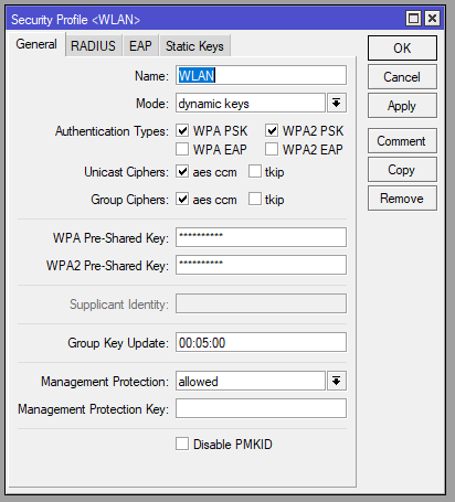

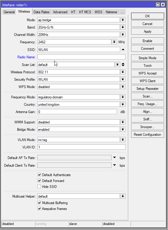

I have a 3 story building with an access point on each floor but roaming between APs is very slow and reconnect is also bad as in 2-3 sec where you can clearly see the is no wireless while the devices revert to cellular connection, could any one offer any tip or pointer for a configuration like this.
i’ve attached images of how each access point is configured (identical on all 3).

Try playing with Connect List/Access List to force a disassociation quicker, i.e. some devices will try hold the existing connection as long as possible, rather than actively scanning for a better closer AP (which uses more battery). What some people do is put a cutoff at say -70db to force the client off that AP and search for a new one, the drawback is if no AP is within range after the cut-off then you may be shortening your own distance, so its a bit of a give and take to fine-tune it to your boundaries, and may require a couple extra AP’s to spread the signal.
Thats one take on it anyways.
@joegoldman thanks this seems to have worked really well, i now get disconnected really quick when roaming and the device reconnect to the nearest AP quiet quickly.
I tested this by roaming between APs whilst making a VoIP call over wireless and there was barley a stutter when switching.
Thanks again great advice!
Try dialing back the transmit power rather than kicking off users below a certain limit.
Seeing as you have 3 APs I’d suggest using CAPSMAN with local forwarding and client to client forwarding on rather than 3 lone APs.
