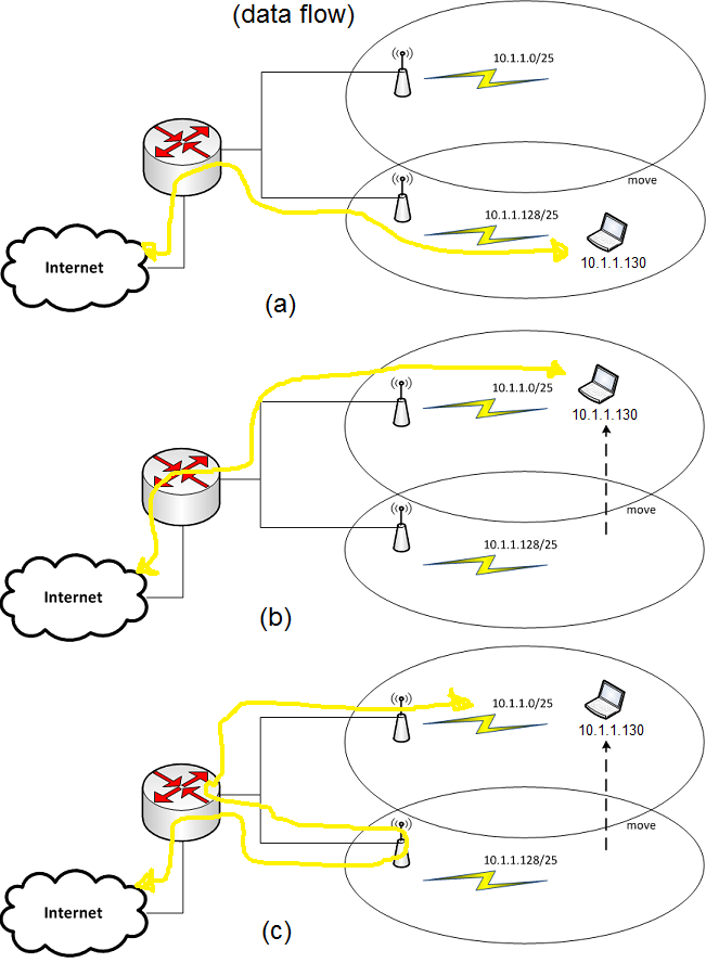

Thanks for idea, I ever tried using WDS and bridge to build seamles wireless roaming but it just running on same subnet (network AP1=AP2). My scenario is just wireless network support roaming in different subnet AP
for example: AP1 set on network 10.1.1.128/25, AP2 set on network 10.1.1.0/25. First client start connect to AP1 he get IP 10.1.1.130/25. Then he move so that he loss connection from AP1 and automaticaly connect to AP2 (still using 10.1.1.130/25) and his device still can connect to in ternet.
any other ideas?

thanks guys! Sory, but I still dont understand your clue :frowning:
When device move to other AP on different subnet, how router know that packet data send/forward to client(10.1.1.130/25) via AP2. I mean that normally router will send/forward data to 10.1.1.130 via AP1 (10.1.1.130 => same subnet with AP1)
In pictur below, after client moving to diferent AP, is data flow become (b) or (c)?
