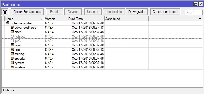

My internet is coming from a Speedport modem which is connected to eth1 of Mikrotik that is acting as a PPPOE Client. In the Mikrotik the IPv6 Package isn’t installed, also under PPPOE the “use peer dns” is unchecked as well.

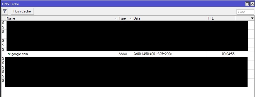

This result is after a ipconfig /flushdns and a flush of the Mikrotik DNS cache. Strange thing is that after the nslookup request im getting an entry in the Mikrotik DNS Cache as well

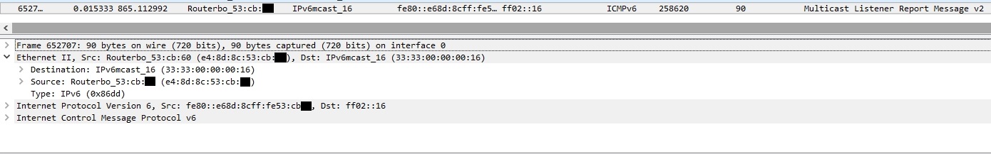

So i started sniffing with Wireshark and i found the following coming from the Mikrotik eth1 where the PPPOE Client is running
So can someone more advanced than me explain me what is really happening here?
How is it possible that Mikrotik is responding to IPv6 DNS Requests and Caching them without the IPv6 package installed and if this isn’t Mikrotik is it possible that this is from the Speedport Modem which is behind the PPPOE ?

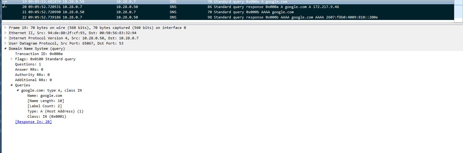

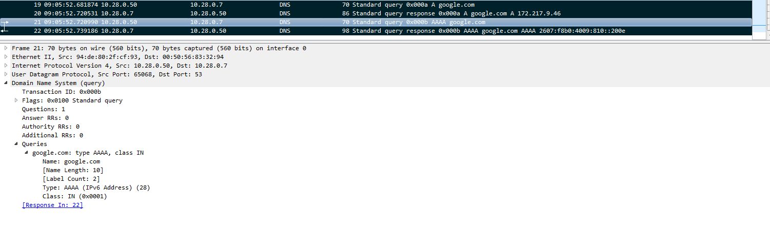

See these pcap screenshots. These are DNS queries sent a Windows 7 machine. Note that it is asking the DNS server for both the A records and AAAA records for google.com. The DNS server dutifully responds to both requests.
IPv4 and IPv6 are communication protocols. DNS is a name resolution protocol. Your systems are using IPv4 to communicate. That doesn’t prevent DNS from providing IPv6 addresses over IPv4.

You made clear the DNS part. But what about the IPv6 Traffic coming from the Mikrotik router eth1 where the PPPOE Client is running ?
If you really have the IPv6 package disabled, I’m not sure why the MT is using IPv6 at all. However, it isn’t important. The packet you captured is a simple ICMPv6. The fe80 address is a link local address (like 169.254.x.x in IPv4).
Yeap the package isn’t enabled,
That traffic and my limited knowledge on the ipv6-dns part was made me to have those wrong assumptions.
