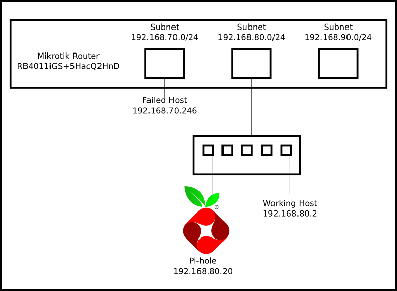

I am trying to rollout a Pihole server to a three subnet network (192.168.70.0/24, 192.168.80.0/24, 192.168.90.0/24).
The evaluation process is to insert the pihole (192.168.80.20) in one subnet (192.168.80.0/24) for initial testing. Then expand the introduction to have a second subnet (192.168.70.0/24) & third subnet (192.168.90.0/24) use the same Pihole server.
For the testing specific hosts in each subnet are configured to use the Pihole. After successful testing DHCP would be configured to direct the subnet hosts to the Pihole server.
For initial testing hosts in the .80 & .70 use the linux dig command to make DNS requests to the Pihole server. Tcpdump is used on the Pihole to monitor the connection.
Dig requests from the .80 subnet host work. Dig requests from the .70 do not work.
The Pihole receives a request and responds to a dig command from the .80 subnet.
WORKING 192.168.80.0/24

The Pihole receives a dig request from the .70 subnet but does not respond.
FAILED 192.168.70.0/24

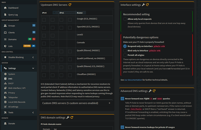

Check this in pihole settings:

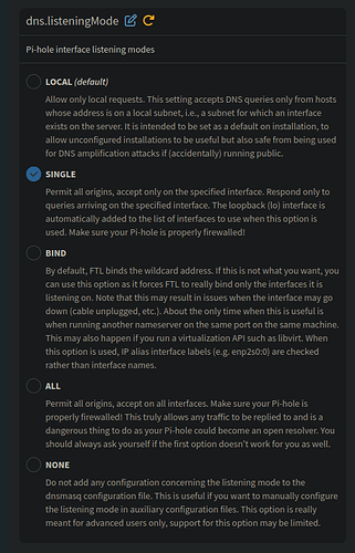

Currently the configuration is setup for LOCAL. listeningMode = "LOCAL" I couldn’t find the configuration screen you’ve displayed. I’m on version
Core version is v6.1.4 (Latest: v6.1.4)
Web version is v6.2.1 (Latest: v6.2.1)
FTL version is v6.2.3 (Latest: v6.2.3)
This is my second foray into Pihole. I played with it when it was in it’s infancy many years ago. I’ve done all my configuration in /etc/pihole/pihole.toml file.
I don’t have access to the system currently. I’m on days off until next week. I went in early to the office this morning to capture the data so I could make the post and hopefully get some responses. Thanks for the reply.
Its on System→all settings, but you can setup in DNS menu also:
You suggestion solved the problem. Thanks for the assistance.
