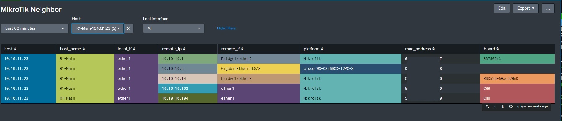

Not directly a reply to your question, but I do use syslog to send out all neighbor a device find and then make a table of it.
Se my signature for more info.
Thanks for the reply. I like the presentation on your picture. Sadly I need romon since I have layer 3 between devices and cannot thus use “neighbors” since it only supports layer 2.

If I can get output of “/tools romon discover” in to an variable (seem to not be possible), you can send it using syslog and get same graph as neighbors.
