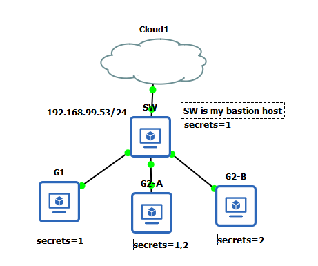

You can have multiple secrets, which allows remotes to use different secrets. You can even if one empty secret (like default) with other actual secrets.
I lab this up and it’s very cool indeed I never know this feature exist :slight_smile:, you can fine tune what you want to see a romon neighbors because a device can have multiple secrets, one use case you can limit the access of your remote network engineer, I just hope/wish that the romon secret key can be bind with the user not on the router itself to make it more flexible

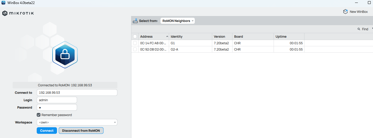

On this subtopic of multiple secrets…
It’s worked like for me. But it’s not documented. The use case I found out while ago was if you normally set a secret, but forget to set a secret on some device with enable RoMON, leaving one blank let you connect to BOTH one with a secret and without. Also having multiple secrets lets you “rotate” secrets without losing RoMON in process.
Yep please see attach to illustrate
