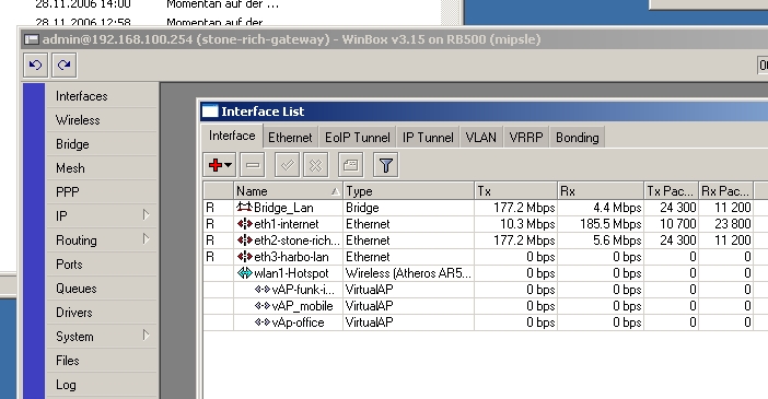

very cool speed with 3.15 - even more then the eths are built for on the rb532 ;-))
this showed at least as log as it took me to see it and make a screenshot …
it has slowed down again ;-(
