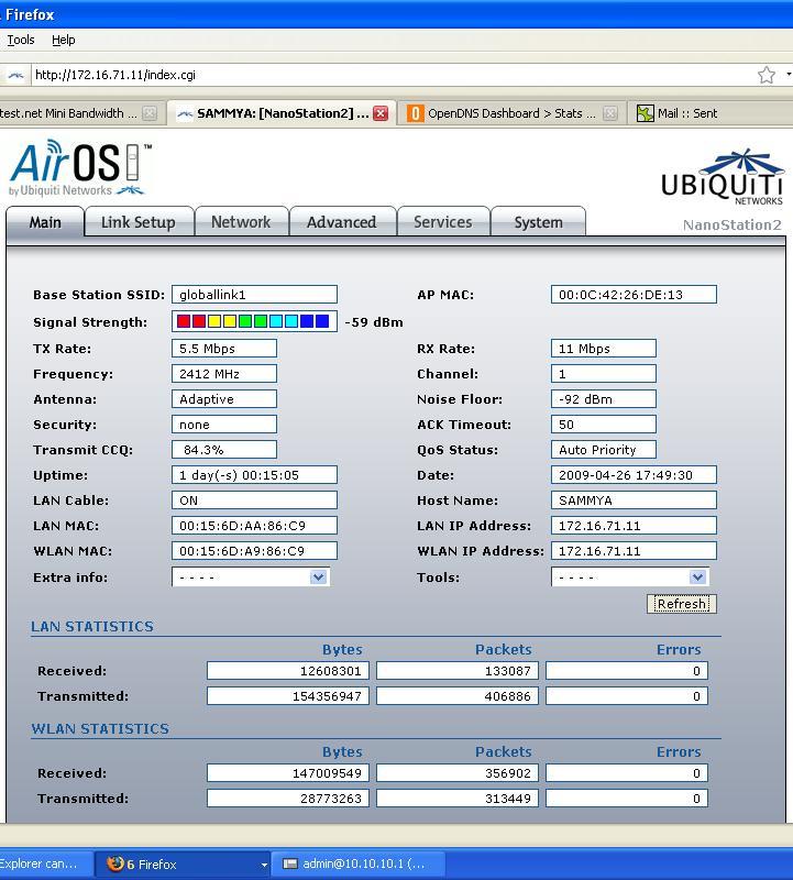

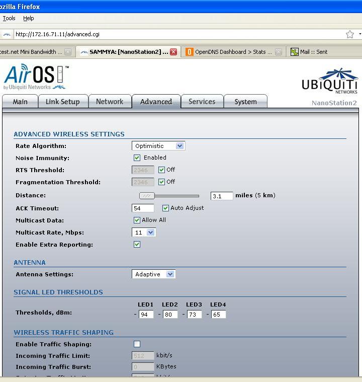

I had the same problem after upgrading to V3.23, CCQ noise dived to less that 5%. I played arround with settings on the NS2 and got CCQ back to 78-100%. The images below show my new NS2 settings.
