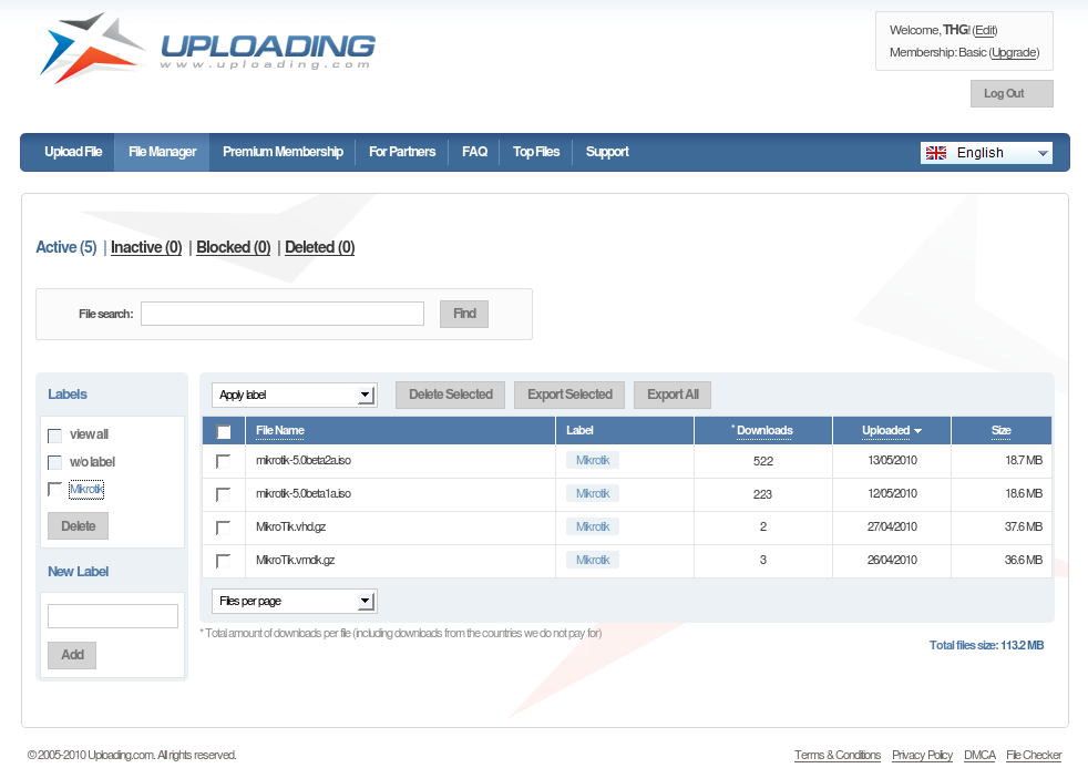

Downloads so far. :open_mouth:
Where is my karma? :unamused:
