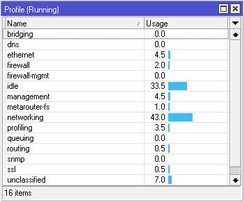

[ROS 6.37.3] MetaRouter: Unable to create virtual routers, OpenWRT slows down host network connectivity
I am unable to boot virtual router instances, they time out after creating SSH keys step, CPU usage on the ‘networking’ process goes high on host machine until I disable the virtual router; OpenWRT boots but the same high CPU happens even when OpenWRT is idle with 0% vCPU usage and slows down network connectivity on host machine enough to kill my OSPF adjacencies.
The interesting part is that I don’t even need to attach a virtual interface, the same problem arises with or without a virtual network adapter attached to the virtual machine.
Tried on both RB2011UiAS and PowerBOX, (MIPS) the same problem shows, I can’t comment on other ROS versions as I started to play with MetaRouter with ROS6.37.3.
