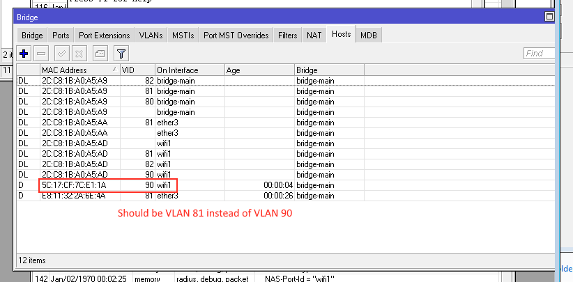

What happened instead:
Client will connect, radius query will return the relevant details, the client is NOT assigned to the correct vlan.

bridge-hosts0list.png - showing the incorrect VLAN assigned
